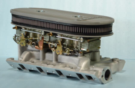

has anyone tried to put a duel quad intake on one of these, i was just looking at one and thought that would be nice.

On an interesting side-note; the full-race-trim Boss 302 engine used for the 1969 SCCA Trans-Am season in all Ford Boss 302 Race Mustangs ran a pair of 1050-CFM Holley Dominators...but that's with an 8500-rpm redline. They lost the dual Dominators for the 1970 season due to rules changes....trying to substitute a 2000cfm 'Cross-Boss' inline 4-barrel carb was attempted, but not allowed....and the Bud Moore 'Mini-plenum' intake was ran instead, with a standard single 1050 Dominator.

Originally posted by bowman83merc View Postwell say i did have a power plant to handle it would it fit with the wiper motor there
Got a particular project in mind? I guess I think of dual-quad setups having been more useful back in the days when you couldn't buy a 1200cfm carburetor. (dual Edelbrock 1404s would only be 1000cfm for all that extra hassle and expense)

On top of that, the only Boss 302 I've helped disassemble had a HUGE mechanical roller cam in it. Probably made loads of HP at about a zillion RPM .....2012 Mazda5 Touring | Finally working on the LTD again!
