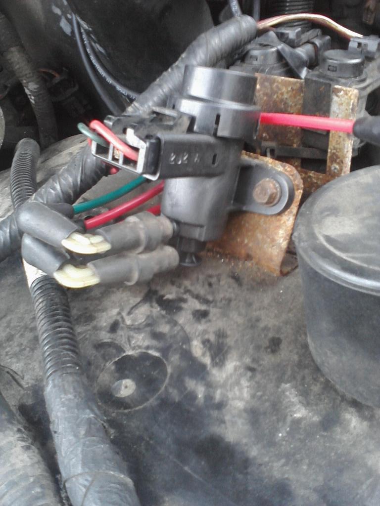

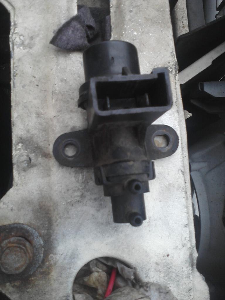

                  I've been getting code 34 when I run my codes lately. (both KOEO and KOER)
                  I've been trying to track down the EGR issue.
                  Things done:
                  • I verified that the valve holds pressure.
                  • I cleaned the valve and the intake where it mounts to.
                  • I re-ran rubber vacuum hoses instead of the brittle plastic lines from the plenum to the egr solenoid and from the solenoid to the egr. (I kept a little bit at the ends as a coupler for the rubber vac line and the rubber end fitting)
                  • I cleaned the connectors to the solenoid and the sensor.
                  • Verified vacuum from the plenum to the solenoid
                  • Verified voltage on the solenoid and sensor.
                  • Cleaned out the solenoid. (Removed "dust" filter)
                  I just was not getting any vacuum to the egr from the solenoid ever. (I read it should go up to 5lbs at throttle?)
                  Just for kicks, I picked up a new solenoid and installed it right now. Haven't checked vacuum yet. I'll have to get back to that.
                  New one installed:
                  Old one:
                  '78 LTD | '87 Grand Marquis | '89 Crown Vic (RIP) | '91 Grand Marquis (RIP) | '94 Town Car (RIP) | '97 Town Car (RIP)
                    #99
                    Disassembled the old solenoid. None of the passage ways are clogged. Everything that I can access appears to be fine. Maybe the coil on the inside was shot? Or maybe it was okay. Still have to test the vacuum to the egr.
                      So, I ended up running the vacuum line from the plenum directly too the new EGR solnoid. I was getting codes for the AIR stuff. Looks like there is a leak in the smog system so I just bypassed it. I'm now getting vacuum at the EGR valve. I think I'll keep it like that for this tank of gas and see if my fuel economy improves. From what I've read here, the smog stuff doesn't really do much of anything so it can basically be deleted completely out of the car.

                        Fuel economy is up with the EGR back to getting a vacuum. I've been getting between 18.5-19.5mpg lately! Thank god. Getting 14mpg was killing me.

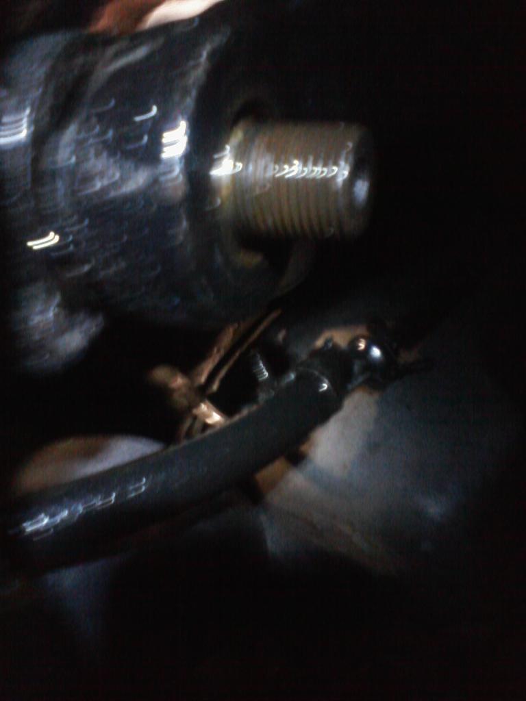

                        The only issue I did run into was the steering yolk retaining nut. It's not a 12mm like I saw when searching this forum. It's actually a 7/16 spline nut. Anything else will strip the living shit out of it. I had to run out in the middle of the swap to pick up a set of spline sockets just for that nut.
                        Anyway, here's some pics of the process as well as a quick write up. Sorry for the quality, my phone is old and these were taken at night. (Started around 8:00pm). The nice thing was with all the suspension upgrades and larger tires, I didn't even have to jack the car up to do this job!
                        First thing I did was remove the nut and lock washer from the old pitman arm. I used a good 5ft long fence pipe to get this thing off. I didn't pry the old pitman arm off because I didn't need it but I did need the nut and washer for the new one.
                        After that was off, we used an impact gun to get the castle nut off the balljoint on the control arm because it was just freely spinning.

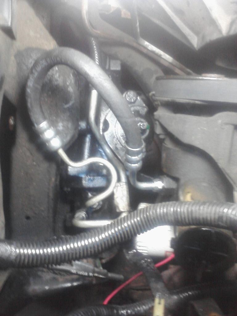

                        Following that, removed the two high and low pressure lines from the power steering pump. The high pressure line requires a line wrench and the low pressure line is a hose clamp.
                        To remove the steering box, there's three bolts (around 19mm?) in the driver's side wheel well that need to come out. We attached a ton of bungies to to the thing so that it wouldn't come crashing down when all the bolts were out. (It's pretty heavy.)
                        After the bolts were removed, you just have to take out that retaining bolt I was talking about that clamps the steering shaft to the gearbox and pull the gearbox assembly out of the car. I went through the bottom, I don't know if it's easier through the top (or possible) but it wasn't bad.
                        Here it is with everything removed:

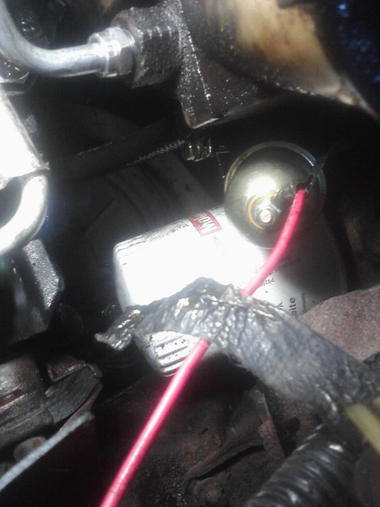

                        Also while we're at it, here's a pic of the oil pressure sending unit installed using the ford extension.
                        To get everything back in, it's basically just the reverse of the removal.
                        Gearbox goes in, clamp to steering shaft. Then hoses from gear box to pump. (I used this time to flush out the power steering pump and make sure it was nice and full with all fresh Type F transmission fluid.) After that pitman arm is installed and pressed on to the gearbox using a huge socket and a long fence pipe as a breaker bar. All in all, not too bad. I wish I remembered what the size of the nut on the pitman arm was... It's definitely well above 1inch though.
                        Also one thing to note, the replacement power steering hoses are NOT 100% the same shape as the old ones so fitting them in requires a little bit of finagling.
                        Here's a couple blurry bad pics of the new stuff installed:

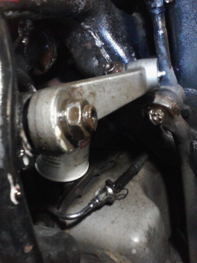

                        And the new pitman arm. I hit it with liquid wrench as I was pressing it on for some extra lubrication. (I don't think it was required though).

                          Why was the EGR not getting vacuum??
                          "Hope and dignity are two things NO ONE can take away from you - you have to relinquish them on your own" Miamibob
                          "NEVER trade your passion for glory"!! Sal "the Bard" (Dear Old Dad!)
                          "Cars are for driving - PERIOD! I DON'T TEXT, TWEET OR TWERK!!!!"
                            There must be a leak in the smog pump vacuum lines. The manifold vacuum goes to the EGR solenoid and that goes to the EGR. Where the manifold vacuum comes in, it also connects to vacuum lines that go to the smog AIR solenoids also on the passenger's side fender. I'm thinking there's a break in one of those. Once the manifold vacuum was plugged right into the EGR solenoid, the mpg problem stopped.
                            I should also mention I was getting the AIR injection codes (I think 94 and 44?) as well with everything hooked up. At first I wasn't getting these codes, just the EGR codes. I must have broke one of the brittle vacuum lines there while trying to diagnose what's going on. I haven't checked lately but I'm pretty positive I still get all the codes currently (EGR and AIR). I haven't messed with it more because my gas mileage is back to where it should be.
                            When I have more time, I'll come back to it unless someone else has any other ideas what it may be?
                              Need to check this myself as my '87 is getting around 12 MPG/city! What's the best way to check it?
                                For me, I made sure that I had vacuum coming from the red vacuum line that comes from the intake manifold to the EGR solenoid. Then I went and checked if I had vacuum ever on the green line at the EGR itself on the intake. I had a vacuum on the red line (pretty strong too) but absolutely nothing ever on the green line (regardless of throttle or engine temp).
                                I unplugged the extra couplings that the red line connects to and put it straight onto the bottom port on the EGR solenoid. After I did that, I then got vacuum at the green vacuum line at the EGR.
                                I'm not sure this is text book correct so someone feel free to correct me.
