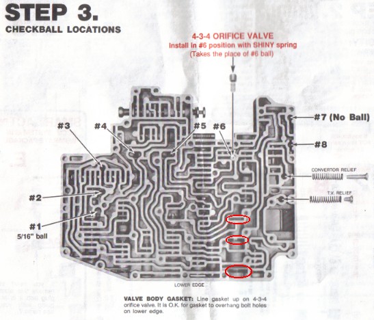

ok on that picture there my valve body has an extra spring on the other side of the 1-2 accum valve. in my instructions it says that if my vb does have that spring, to discard it. but i cant get to it because i cant get that 1-2 accum valve to come out of the valve body. its stuck :chainsaw:
The valve is just stuck in the bore. it can be a PITA, but it will come out eventually, keep trying.2003 Town Car Signature - 3.27 RAR, Dual exhaust and J-mod - SOLD 9/2011

On my install of the hp kit, I had one stuck too. What I did was I took a big drift and smacked it with a hammer light but sharply and it came out. It will come ot with a little help.
