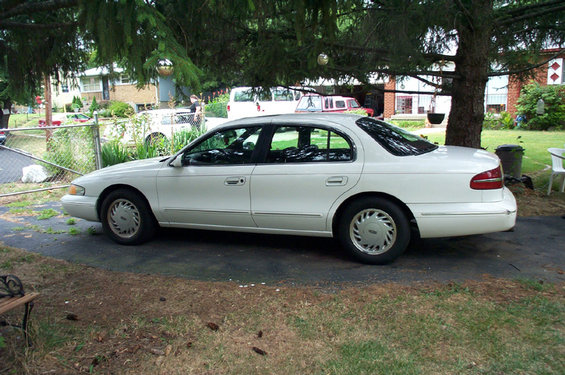

            I had a '95 Continental for awhile. It was a fun car. Nice pep and lots of toys! Just expensive to work on.
