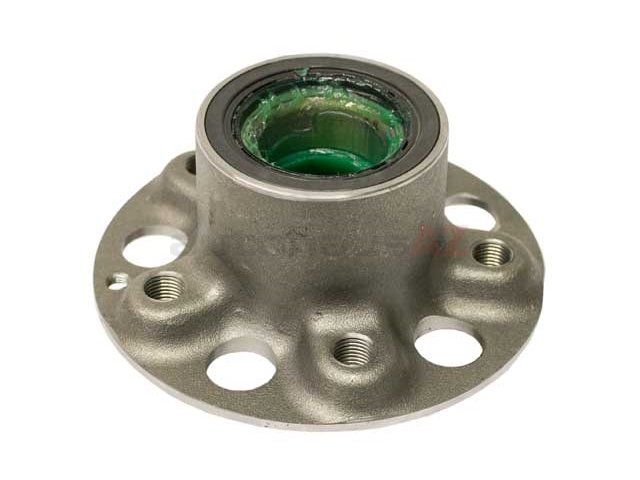

                    OH and for some strange reason both drivers side (worse) and passengers side wheel bearings were loose. Popped the wheels off and knocked the dust cap off and tightened it up a smidge to get the play out of it. Don't know how I did not notice last week doing the upper ball joints. Its a nut with a pinch bolt kinda deal. no cotter pin or anything and you tighten it similar to box panther wheel bearings.

                      surprised thats not a sealed hub bearing assembly type of thing.
                        Backside view of a front hub assembly:
                        And a view of the nut with pinch bolt:
                        and some from 2016 when the install was done:
                          so is it taper roller bearings like old style box brakes?
                            Yeah. Inner and outers.
