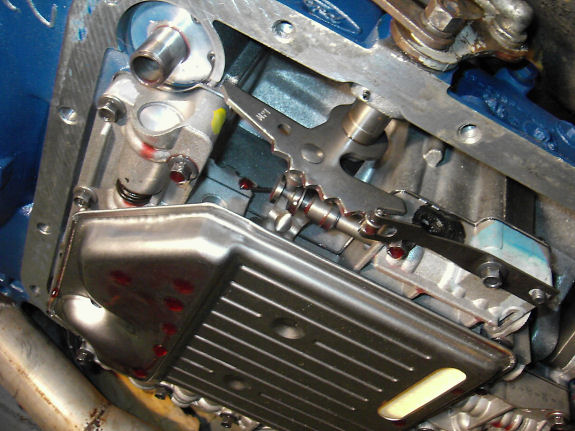

                        If you are brave enough to trust your tranny on a single 1/4" high-strength bolt and nut you can do this and never worry about the cable popping out of the TB plate:
                          I see you utilized the brass fitting, but how did you rig a nut in place of the plastic post on the cable itself?
                          BTW, it's nice to see another person with the name Ivan!!
                            It's just a 12.9-class 6mm bolt that goes through that black steel plate, the brass bushing, a stainless steel washer, and the nut with the plastic friction ring. Now the cable is attached to the black steel plate via two high-strength 5mm bolts with a side hole in them (if you have a bike this is what holds the shifter cables to your derailers), the cable goes through both of them and when their nuts are tightened it gets tightly pressed againts the steel plate. There is also one more bolt with a side hole in it, this just hangs on the cable to prevent it from sliding out in case the two 5mm bolts loosen up - not really necessary, but I like things overkill The whole thing is a bitch and a half to adjust for TV pressure, but I trust it much more than the stock plastic crap.
