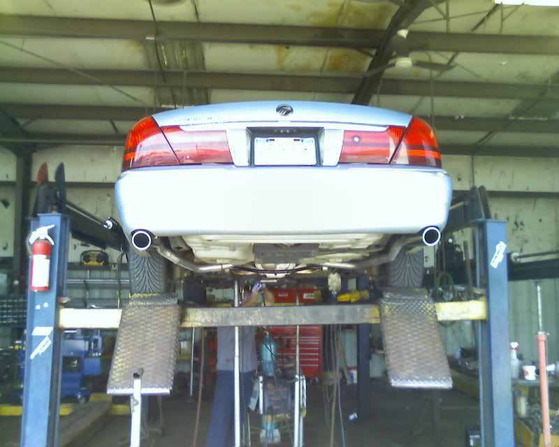

            Your thoughts on exhaust are correct, here's what was removed from my car when the exhaust was upgraded:
            I thought about doing the same thing that you're talking about with exhaust, but when locating all the parts and tracking down the things I needed became too difficult, I broke down and had a full custom cat-back with an H-pipe fabbed. I liked that a lot better:

              How much did you pay for that fabrication job? Did they cut the bumper? And what in the world are those black cylinder things on the front of the y-pipe (I've seen them under mine... wtf?)?

                The exhaust I'm thinking was just under $600 (I think I made a post right after I'd gotten back with better details - my memory is crap!), which included stainless tips and stainless Magnaflow mufflers.
                The bumper is already relieved on both sides, they didn't have to cut it at all. I think I remember being told that the black things were some sort of anti-rattle device? Regardless, mine went on top of the junk pile and there aren't any rattles or squeaks.
                I did the exhaust after the sway bars to make sure they wouldn't interfere with each other. After watching the guy bending the pipe for the exhaust I'm glad I did; it would suck to have to do it twice... it looked like a pain.
