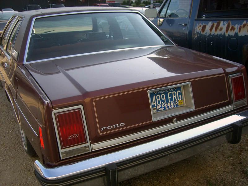

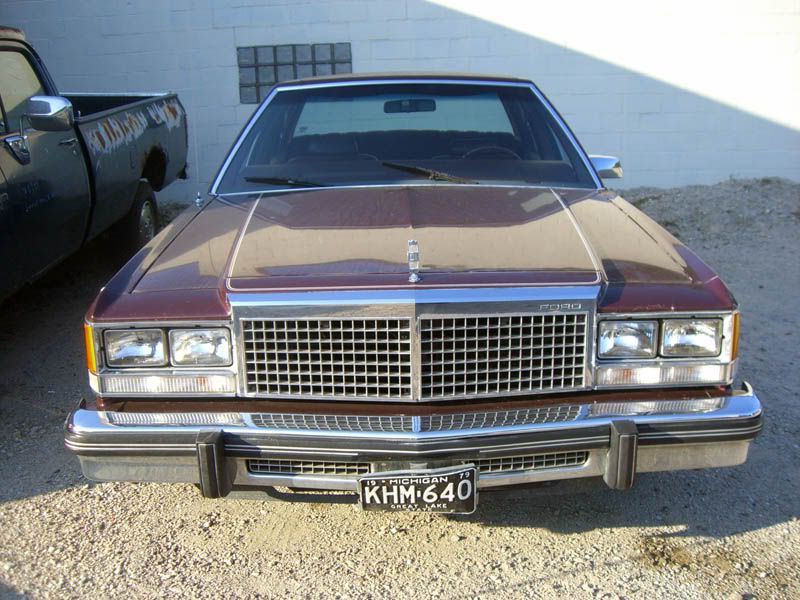

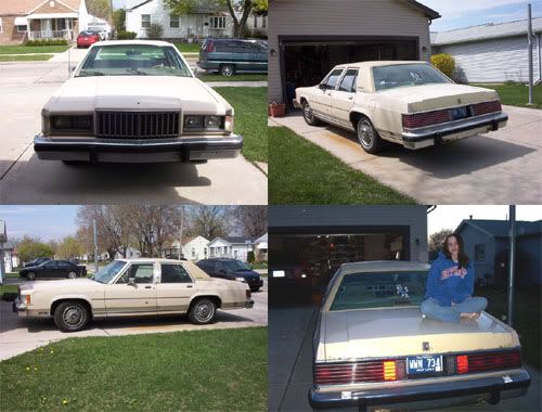

      This is my new LTD, "Handsome":
      This is what was my very very very favorite GM before it got rear ended by a semi skidded around and t-boned a Blazer, my '86 "Beast":
      And after (I cried for days straight after this happened. It was like my heart was ripped out. It had belonged to my Papa before me. I swear this car loved me back)...
      My '91, "Junior":
      And last but not least, my '87, "Tank" (I cried when I had to sell him):

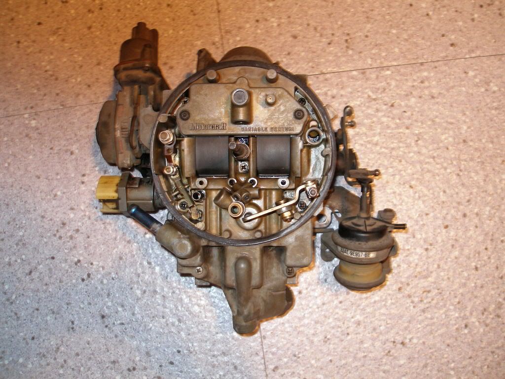

              I'm assuming your car must have the Variable Venturi carburetor, same as my '89 P72 has. Does it look like this?
              Where is the leak? If it needs to be rebuilt, it's not nearly as difficult as some like to make it out to be. There's an article in our tech section that I wrote on how to do it.
              EDIT: Sorry, missed what you said in the first post. If it's leaking from the fuel inlet fitting, more than likely the fitting is just loose, or as you suggested, stripped out. Have you tried tightening it at all to see if the thing has just vibrated loose a bit?

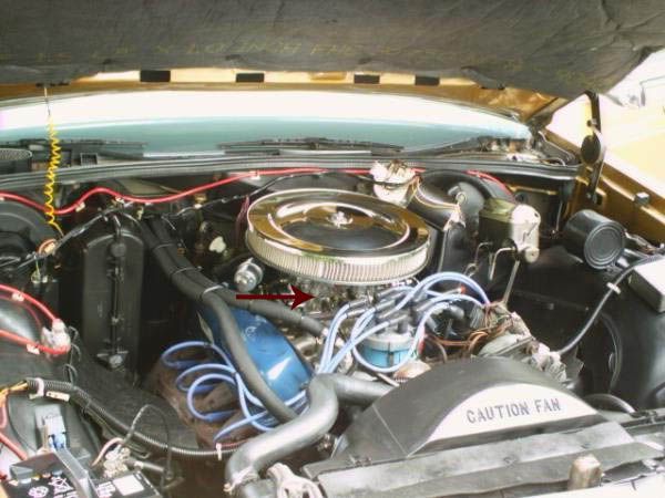

                Ok, this is not my car's engine, but this picture allows me to point out where the fuel drippage can be seen... The arrow points as best it can to where it can be seen. You can see it just looking right under the air filter in the front.

                  Yeah, given the location, I'd say it's an inlet leak. That being said, if it's a VV, there are a couple of possibilities for the source of the leak. One would be the fitting on the end of the steel line that goes into the carb, the other would be the inlet fitting on the carb itself. My guess is that one of them has just come loose and needs to be snugged down a bit. Does the car seem to run all right otherwise?
                    Oh yeah, car starts right up and runs like a cat on carpet. LOL. We smelled it running rich when I first looked at it, but failed to locate the source of the smell until today. That's why I was confused when the mechanic tried to tell me the carb would have to be rebuilt or replaced, because the car is obviously getting gas and running fine otherwise. It just had an oil and coolant change and new battery installed, after sitting for three years. I know it will need brakes soon as well, and I'm having them change the belts as well. Hoses all looked good and not rotted. It was gone over completely before being started, so I don't understand how they missed the massive fuel pump leak... the carb leak I can understand since it is literally just a DRIP. What worries me most about that drip is that it's dripping down right onto the plugs.
                      Well, the first thing I'd try is tightening up those two fittings to see if that takes care of it. Until you get a chance to do that, if you can avoid driving the car, it would probably be wise, as it obviously is a fire hazard. We wouldn't want you burning up that pretty car, or more importantly, yourself.
