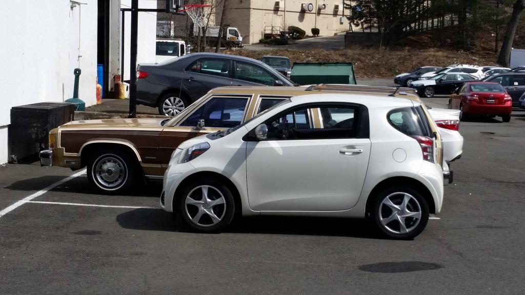

                Also also, just for a comedic effect.
