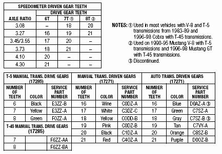

      Here is the speedometer gear callibration chart.
      http://www.grandmarq.net/vb/showthre...highlight=gear

              Page 144 of the 2006 FRPP catalog list a 6T.
              Copied from page 144:
                Ahh, but now I see that's under the T-5 section.

                      Mmmm... the plot thickens... both cars have a gray 18T driven gear.

                      It's interesting that the 3.27 geared car had the gray 18T, that's wrong no matter the speedo drive gear.
