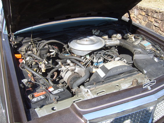

                    Here's about the only pic I have of my engine compartment (not much to see...). It's all smog junk over there. There's the gigantic air diverter valve over there, and air comes out of that. That's probably what you are referring to. Later cars had it mounted down lower after the smog pump, and a more compact setup.
