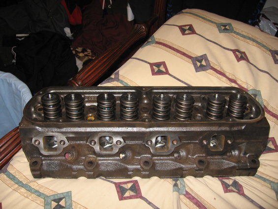

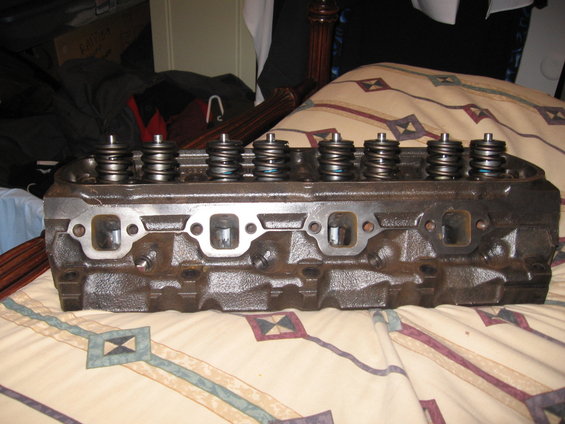

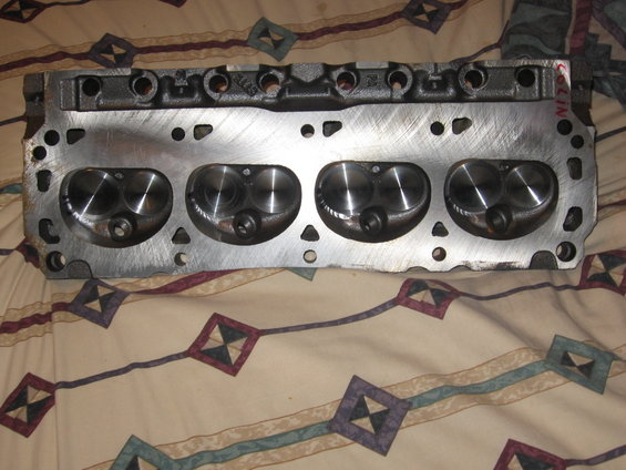

                  here's what mine looked like after I got them ported by turbo2256b
                  dont be deceived by the pics, those heads are very clean..or, they were...they're on the car now.
                  my car is noticably faster...but my Carb isn't working right...only running on 2bbls....but once tuned, should be making some serious power.
