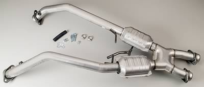

      I think you should get some Mustang shorty headers, 2.25" downpipes and a Mustang H-pipe (also 2.25") with turbo mufflers. That'll flow far better then stock and sound much nicer. You can put turndowns after the mufflers or if you want to run it out the back get some Impala SS tailpipes, which may require a bit of work to fit because they're 2.5" diameter. That set up will also work for future engine upgrades.
      Or, you can just get a stock H-pipe off a Vic/GM/TC with duals and gut the first set of cats and run no muffler. Won't be as good as the first option but it's still much better flowing and sounding then stock, and a bit cheaper then the first option.
        Only do 2.5" if you're staying with single exhaust. A stock Panther doesn't make enough power to get any large benefit from 2.5" exhaust to begin with, and 2.5" duals on a stock lopo is just a waste of time. Getting rid of that gigantic constrictive muffler is going to help you a lot as it is.
        And if you're looking for easy duals, use stock tailpipes. Sidepipes require a bit of planning and modding, and it sounds like you're trying to keep cost/effort to a minimum. These cars weren't made for sidepipes... you have to really want them in order to make it work.

                    An H-pipe provides back pressure be evening out the exhaust from both pipes, and it also gives the exhaust a deeper rumble too. It's definetely worth it and the stock 2" H-pipe can be had for very cheap.
                      Originally posted by 88Vic View Post
                      Oh, I never realized that was all one, I thought it was in pieces (I have seen it in pieces before, must have been a home hack job), my mistake.
                      It's possible you saw an H or X pipe that was meant for long-tube headers, in which case they're quite a bit shorter.
                      Originally posted by brokebill View Post
                      should probably just get rid of the catalytic converters all together . and an h pipe is worth my trouble? its function is exactly? sorry, just trying to get a real grip. thanks
                      Your car has two exhaust manifolds, one off each side of the motor. The Y-pipe is shaped like a Y and makes the two pipes merge into one. An H-pipe looks more or less like an H. It maintains the dual exhaust, with the middle part being a crossover to aid in balancing out exhaust pressure. There are also X-pipes which are more efficient than H-pipes but also more expensive. The picture 88Vic posted above is of an X-pipe. There are no X-pipes made specifically for a Panther, those would either have to be a custom job or Mustang parts.
