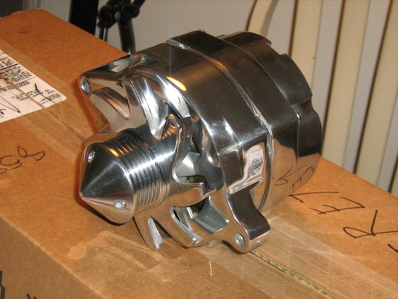

I notice that the voltmeter is at about 12.9V when the car is at liek a 650rpm idle in gear...but as soon as it hits 900ish it goes to about 14.8V or so.
However, I am running a stock Amperage Alt...I dont have my 100Amp Chrome one in yet.
appreciate the offer Mike, but I already have those Hooker Aero Chambers.sigpic
I'd put in a heavy duty alt, but chrome holds the heat in and an alt isnt one of the first things you think of to dress up an engine. Powermaster makes decent alts, at least for my chevy. 140amp rocked my ass off.Chris - A 20th Century Man \m/ ^.^ \m/
Originally posted by Mr. Land Yacht View PostI already bought it close to a year ago so it's goin in whenever the old Alt gives me trouble or if I'm bored and have nothing else to mod. lol
2009 Ford F-350 6.4 powerstroke diesel. 1977 Ford F-150 built 300 six, 5 speed trans. 1976 MG MGB roadster, 359w, t5 5 speed. 1996 Kawasaki ninja ZX6R.
My rod is glowing, my bead is clean, my middle name is acetylene
ooh a polished altenator to go up in flames
Originally posted by Mr. Land Yacht View PostI notice that the voltmeter is at about 12.9V when the car is at liek a 650rpm idle in gear...but as soon as it hits 900ish it goes to about 14.8V or so.
I have a bit of a charging issue even with my stock pulleys ... idling in gear with the lights and blower on, it drops to about 13 Volts, just as you say, and then jumps back up to 14.whatever when I hit the gas. Can't remember who, but I think one of the guys here said the stock 2G tends to do that ....2012 Mazda5 Touring | Finally working on the LTD again!
idle output on a 1 wire alternator is usually poor or nothing. they don't self-excite at low speeds most of the time. The stock type regulator on a 3g will pump the volts at idle. i can run the AC on mine with that power whore electric fan going and it never gets under 13.86 Lincoln Town Car (Galactica).
