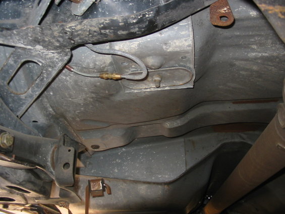

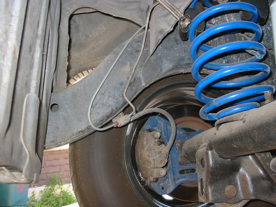

          here is how i did mine.
          this is the drivers side tee
          here you can see where i spliced the new line in with the old hard line

                    its pretty simple, cut the donor line as far up as you can, unbolt the tee and the mount on the passenger side, disconnect from the calipers. use the bolts off the donor to attach to your frame (the holes should be there) connect to the calipers and splice the line in with your line, i used a flare fitting, but a compression fitting will work also
