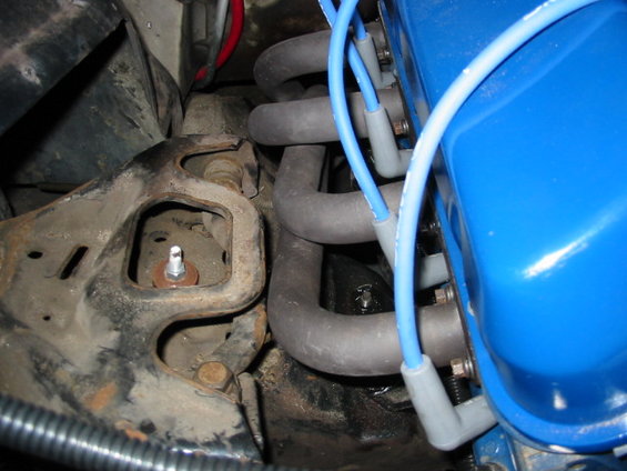

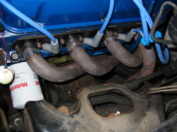

mine are basically long tubes, just missing the last turn. the passenger side fit with no mods, but i dont have a AC box. the drivers side had to be brought in towards the head about an inch and the #8 had to be brought in even more and had to be dut and welded to line back up with the flange
These were originally fox body mustang headers, and the #8 tube originally went around the steering shaft, you can see how much had to be removed so that it would clear the shaft.
passenger side, the tubes come close to the a-arm, it will actually hit if the arm is all the way in.
