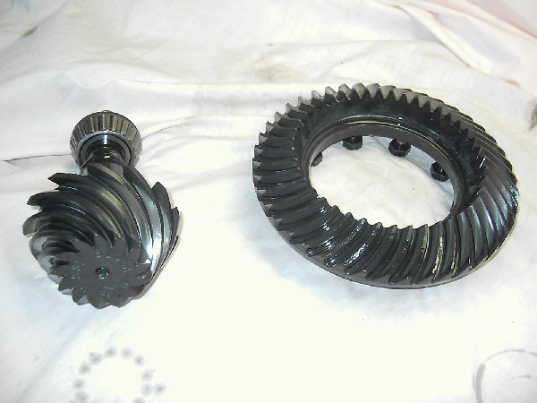

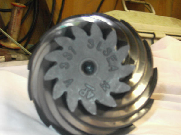

Well I was under the impression that 3.08, 3.27, 3.55, 3.73, 3.90 were all the 3.xx ratios available. Now I guess it's new, but they have a 3.31 gear too. This is cool, cuz it gives me a little more than the 3.27 but better economy than the 3.55.

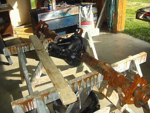

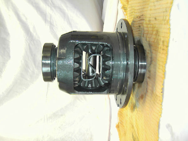

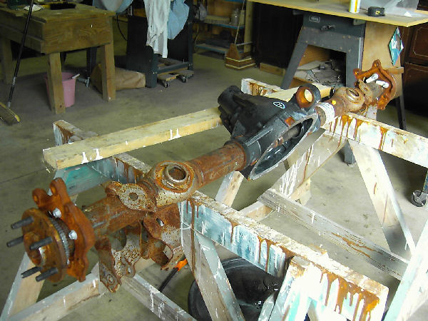

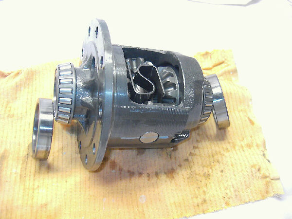

I broke down the 2005 Mustang GT rear end to get this gear. Pics below. I'll be using the gear, however my Dad doesn't care to sell it so he gave it to me to sell. Let me know if anybody needs a 31 spline LSD carrier with less than 3000miles.
As I've been doing a lot of research on the 31 vs the 28 spline I've learned a lot. The spider gears are interchangable, side gears are not interchangable from open to posi. Carrier differs in part number. Rear gear i not effected by 28 or 31 spline, nore is it effected by ABS ring. 2005 Mustang GT rear uses ABS rings at the end of the drive shafts, not on the carrier.
I wish I could use it, but spending the money on custom axels to use it would be a bit too much right now, even though it's only about $250.
