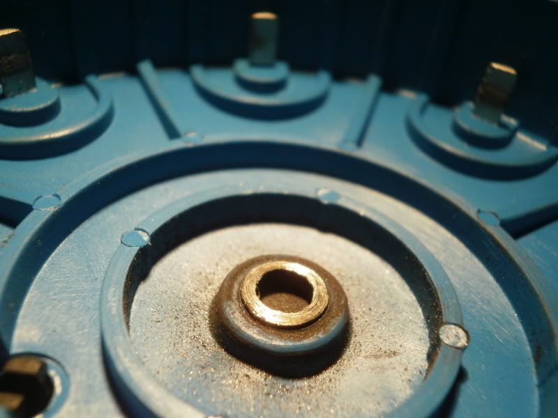

                    Got it!!! A very nice looking cap was the problem!!!
                    Where the rotor rides against the kap the contactpoint (normaly of graphite?) was totally gone! The rotor made contact with the metal around it, which is totally eaten away.
                    Why is it gone, condensor?
                    I testdrove it and it was butter smooth. No stumble or hessitation or stalling, nothing!
                    I also reset the EEc before ride and read the codes afterwards, KOER and KOEO.
                    Only: 31, which is the egr not installed.
                    I also installed the original vane in the distributor. I will order a rebuild correct distributor to be certain to have a correct one.
