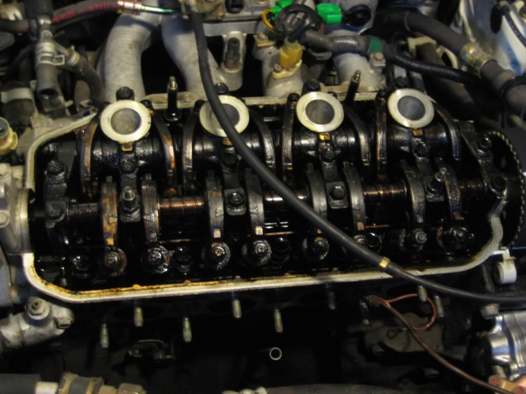

              Lots of bad info running around here, so I'll throw my two cents in.
              Case number one--7,500 mile changes on conventional oil (per the owner's manual in a 91 Honda Civic. The picture below is under the valve cover at 142k miles.
              All the maintenance records came with this car when I bought it, so I know they followed the (non-severe) service schedule. I bought it with a burned valve, however, so I can't speak to its oil consumption. The valve seals appear to be in ok shape though. However, it appears that conventional oil cannot stand up to the kind of abuse that a 7.5k change will put it under.
