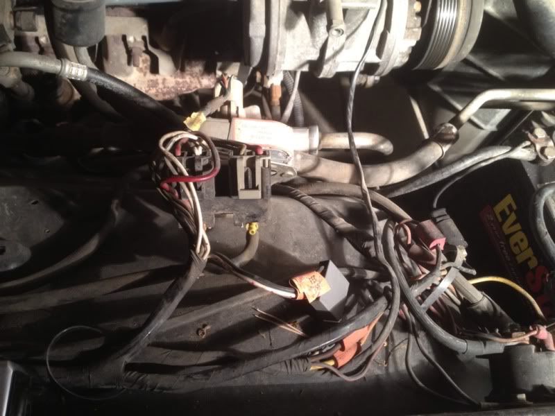

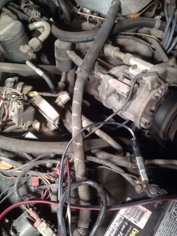

    Wanna clean it up a little, already removed the smog pump and hoses, but gonna keep the ac.
    Can I get rid of this hose that goes from the intake to I'm guessing the charcoal canister?
    And what all else can I remove here on the wheel well?
    Thanks

          Really want to keep the injection, it runs pretty good. Can I remove the charcoal canister without probs?
            like gidget said, if it runs good leave it be. keep the charcoal can imo
              unless you are going to convert to an EEC-lV to run the CFI, a carb or later EFI, leave everything alone, and start planning a budget to replace the 30 year old sensors.
