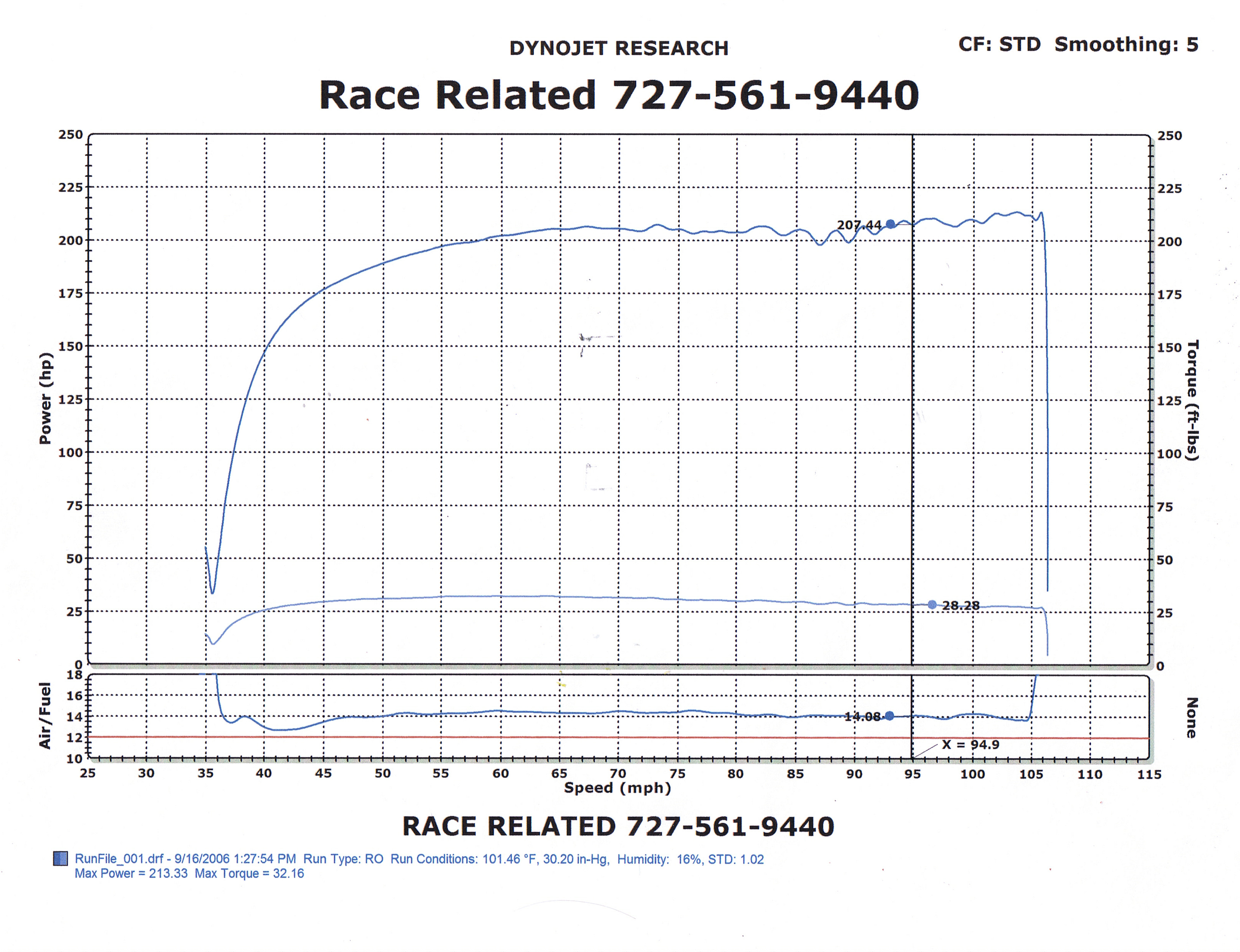

                        similar to my old set up but i had a better intake, i think i put 230 to the rear wheels
                        edit
                        i actually put 213 to the wheels
                        huge version here http://www.supermotors.net/getfile/4...l/dynorun1.jpg
