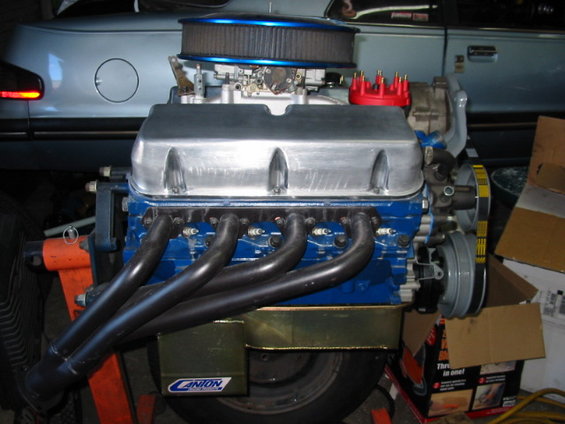

windage trays attach to the tops of the main caps, they dont effect the oil pan depth at all. and there is more than enough room to fit a Canton 7qt race pan in there. one of these.https://www.cantonracingproducts.com...ion&key=15-670
thought i had a picture showing the clearance, but apparently i dont
