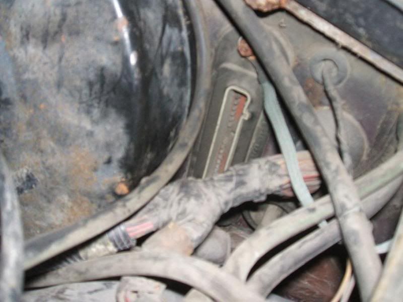

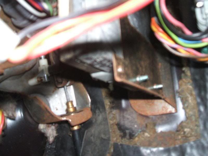

                    Discoverd my car has a ECM in the fire wall, but the car is carburated. There is nothing pluge'd into it nor is there any wireing there for it at all. Did all mark VI's come with the computer, even with the carburated option?
                    1980 Lincoln Continental Mark VI Signature Series
                    351 4 bbl, AOD, 3.08 open
                    duel exhaust with cherry bombs
                      im not sure on that. my brochure talks about the 1980 model year just having CFI and how awsome it was to be lol. my mark VI is an american car that looks like it had CFI but then converted to carb. its got the duraspark box and everything but, still has the wire harness and the ECM in place. im guessing it was a profetional install once apon a time lol
                        I seriously doubt they all came with an ECM. Most likely it used to be CFI and the CFI died or someone couldn't figure it out and changed it over. Hopefully if thats the case, the CFI harness ws cleanly removed and not just partially hacked out. Without the ECM, and without the funky fuel flow thingy next to the carb, you won't have any of the fuel economy features. The rest ought to work though.
                            A LOT of these cars had variable venturi on them, so a lot got converted to dura spark 2 and a carb. so they would also pull the wires for that 3 system out.

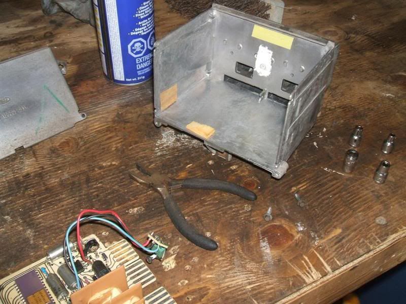

                              Ok removeing the messege center brain box shouldent effect anything else should it? I wan't to take it out and take it apart to check the connections and see if there is anything else that might be causing it to not work..

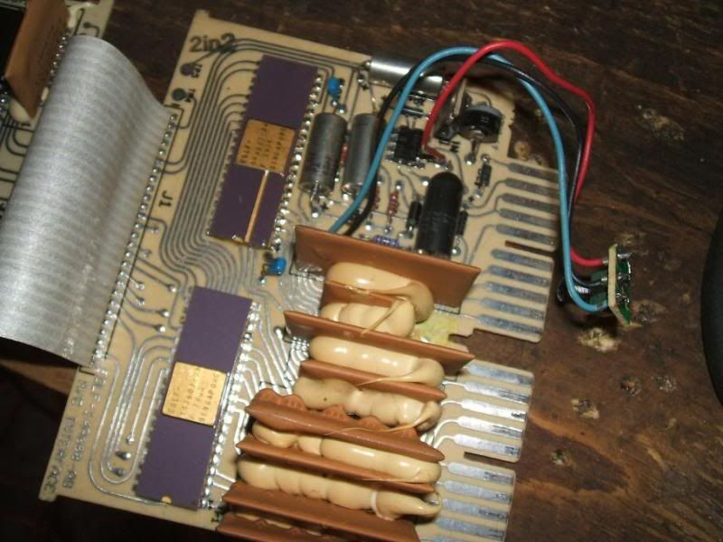

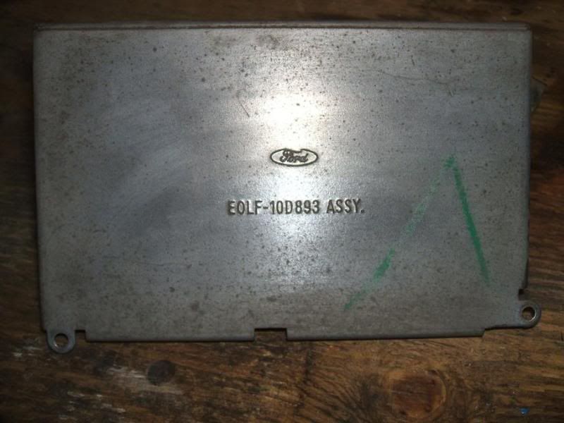

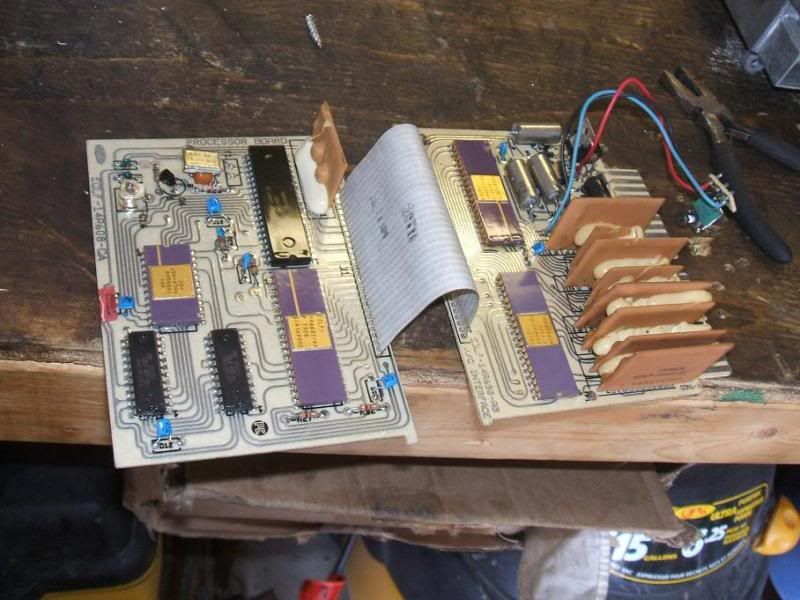

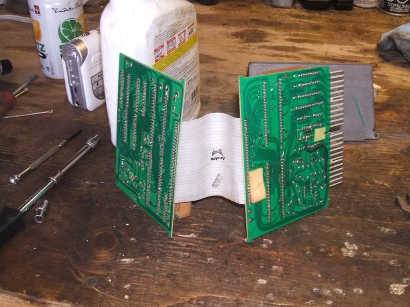

                                Nevermind. Already had it out and apart. couldent find any visable damage like broken solder joints or anything. Cleaned it all up, and cleaned the contacts where the plugs go. Put it back in and still nothing. So I am assuming the capaciters are shot. I am on the look out for a new brain box, so if anyone has one laying around let me know.
                                The part number on it is "E0LF-10D893 ASSY."
