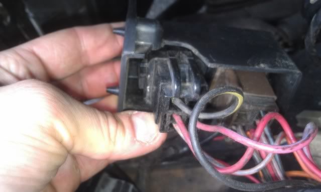

    Photo of my relays below
    Which one is which? Which is eec relay?
    I do see a bare spot on a wire at that gray connector

                    I'd also be looking at replacing those connectors. I see bare wires going in there.

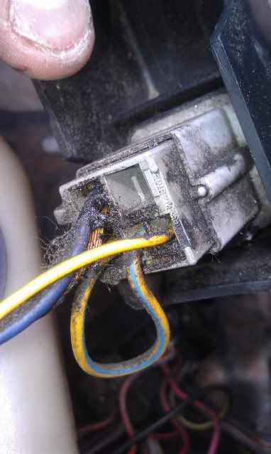

                      Yeah, idk what that relay is for. Any idea?

                        the one by itself is the AC WOT cutout relay. The other two are fuel and EEC, but I can never remember which is which.
                          the horn relayis also floating around in that vicinity iirc.
                            the one with the yellow-blue jumper wire (that fat one from one leg to another) is the horn relay.
                              must be a different design on the horn relays on later cars. My 86's horn relay is all metal and screws to the inner fender.
