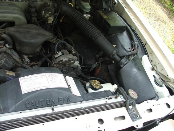

Evolved washer fluid & coolant overflow tanks...
Just wanted to add a shot of this done to the 91 with the airbox that accompanies the shroud in the 90 Town Car
Thanks, I may just cut the original coolant reservoir off the tank duo instead of getting the new tank. Not sure, yet.

yup - just cut the wires and use crimp butt connecters to join them. On mine, the wire colors were the same.
Leave a comment:
Pete, when you replaced the washer tank, did you have to rewire the plug for the tank pump? I was at the yard today and noticed that the newer plugs are different from the '91 and older models.

just wanted to mention that I recenlty replaced my radiator, and the 90 towncar shroud did not fit this new radiator nearly as well. I had to do some cutting and it still didnt fit like I wanted at all. Lets just hope its secure enough...
The radiator is the same freakin part number from the same comapny, Everride radiator. For starters there's a stupid rod running vertically in the middle of the thing that folds the nut tray down a little and gets in the way.
I am not happy, and it makes me want an electric fan.
Leave a comment:
a mustang shroud may work, Im pretty sure they just have the coolant bottle attached like this one. Its possible though the mustang radiator is smaller, but if not it should fit with slight cutsom fitting needed at most.
Leave a comment:
Would a 86-93 mustang GT fan shroud work or is it smaller than the 90 town car shroud? The mustang shroud looks similar except I think the washer bottle mounts to it also?
