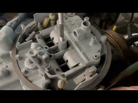

              Haven't done much since last month. Driven the car once since I brought it back over to my new place to get keys, and back. Got to drive through a massive thunderstorm while doing that, very fun without the A/C, very stuffy inside. Drove good through it though.
              I also added some LiquiMoly Lifter Additive to the oil. Surprisingly, the ticking has gone way down once the car gets warm. I distinctly noted two lifters were ticking at one point, now its just the one on the passenger side, but it's much quieter now. The oil has also gotten dark very quickly since adding it. Considering the massive chunks of sludge that was removed from the valley, I'm wondering about the oil passages just having some crud in there and slowly getting it out of the system. Guess I'll keep running it and change the oil in about another 100 miles with some HDEO with good zinc content instead and a little more additive.
              Also because I have no chill:
              Here's a 2700VV carburetor. Got it and the 1979 manual for $100, so I'm cool with that. Added an extra inline filter since I'm not 100% of the fuel tank condition and I'd rather not make the internal filter dirty quickly. Slapped it on, cranked the engine over and it lit off fine. Took it on a test drive and found the throttle response is much nicer. Pleasantly responsive at part throttle cruising.
              I think one thing I'd like to look into is the shift schedule, sometimes at lower speed around 12-16 MPH, it kinda hunts between 1-2. It'll upshift into 2nd, you'll give a touch of throttle and it'll go back to 1st, then promptly back to 2nd. Not sure if a different vacuum modulator would improve that condition.

                The idea behind the VV really isn't bad. Keep the venturi size only as big as it has to be so the air speed through the carb is high and you get better mixing than a reg 2bbl carb. The bores are kind of small though so I have to wonder if its not a choke point at higher rpm.
                  #83
                  At WOT, I couldn't tell a difference between this and the clone 2150. Part throttle operation definitely was better, but I know I didn't have that 2150 dialed in properly, and that's mostly on me since I have my vacuum gauge on loan to a friend and I really needed that to best set the idle screws.
                  This unit seems to be responding fine to throttle input and vacuum changes. You can definitely see the fuel spray with high throttle opening, otherwise it's considerably more limited in normal throttle input. I'm sure folks will think I'm wonky, but after reading more about this particular unit, I think it's worth giving a whirl. The manual seems to note issues with the early 2700VV units, with most issues resolved by late 1978. This is a true 1979 model from what I can tell. There's also a lot of notation in the book regarding the 7200VV feedback units from techs in years prior. Much more of the fuel enrichment and some metering aspects were controlled via the MCU feedback controls.
