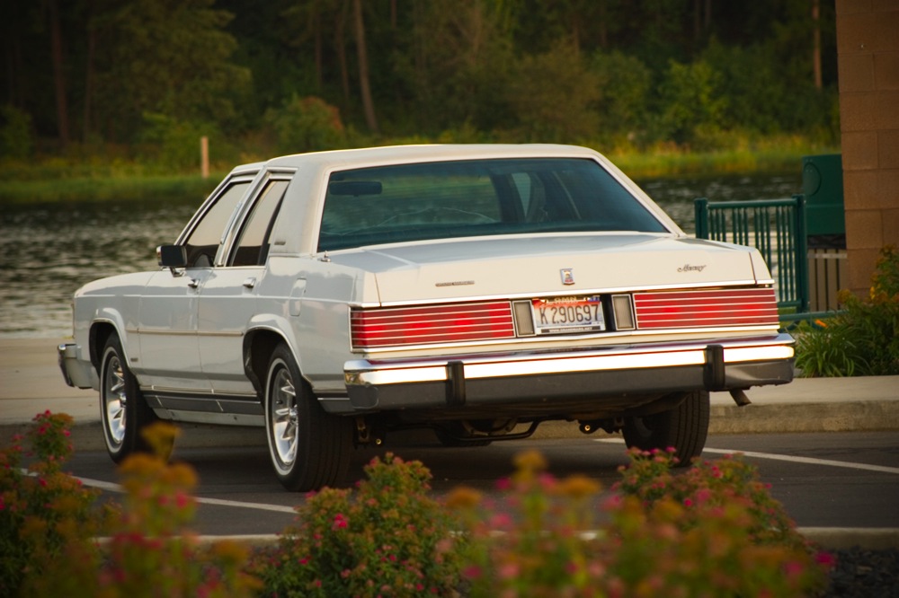

RESULTS: Very happy with the added performance of the 3.55 gears, zips around town much better and gets better mileage, even with me stepping on the gas at every stop. The new suspension is much stiffer, not that same old saggy rear end. Its got a little bit of rake now too which looks perfect. There is a little noise coming from the differential but its not too bad, just a light hum, more so when you let off the gas. Braking is a lot quicker and more solid feeling too. I managed to not get pissed off at all doing this too which was good for a project of this size, although the fifth or sixth time i got the floor crawler stuck on an old coil spring insulator i was a bit irritated
