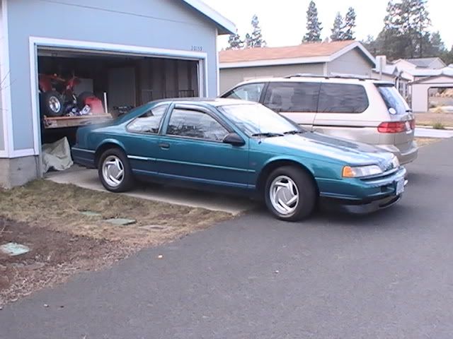

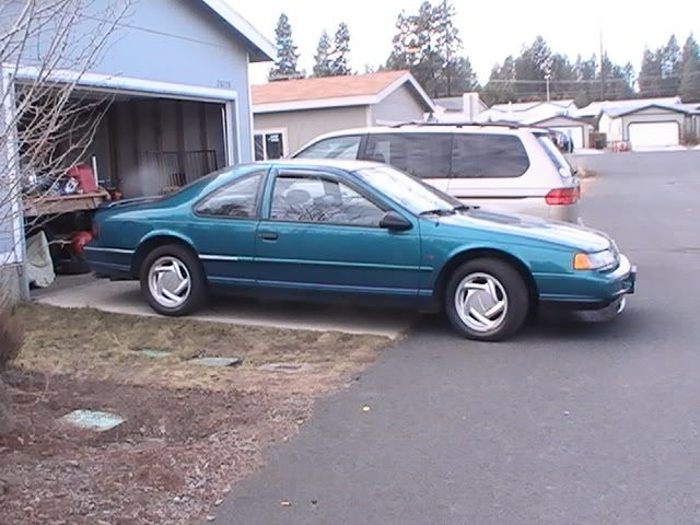

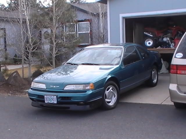

                      This is with the Xenon air dam loosely in place....these were taken Tuesday.
                      ...and that's all for now. I currently have the driver's door mirror off of the car, awaiting a replacement...but I'm not sure I will be driving it until I get it painted, so I may leave the mirror off for now, as I have two new outside mirrors coming from Ebay.
                      I just snagged a set of 1991 T-bird SC black leather seats for an upgrade, as they came out of a low-mile car, and the new rear seat back is a 60/40 split only available in the SC's...
                      The gold van is my wife's Honda, and that 4-wheeler back there is my toy...the 2002 Honda 400EX.

                        That T-Bird looks great Pirate. What color are ya gonna paint it? I thought you were getting '95 Cobra R wheels for that car? Perhaps I missed sumtin.
                          #87
                          It's going to be exactly the same color....and so far as wheels are concerned, I'm snagging a set of 18" Saleen Speedline replica wheels for it as soon as I find a decently-priced set.

                                The wheels are an improvement, Larry. The front lip thing there is ok; you aren't going to put a complete ground effects kit on this, are you? Take those vent shade things off too (convenient, but hideous). Still planning a hood?
