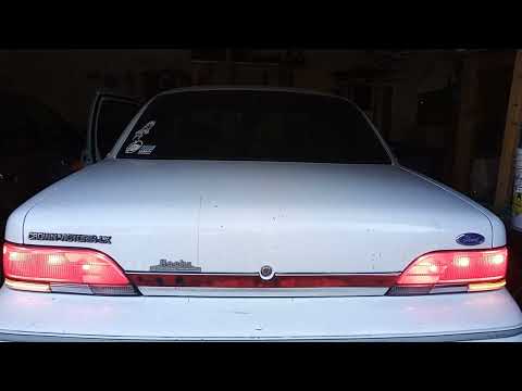

                              Updated video of the tail lights with the clear ambers instead of the smoked ones. Looks much better.
                              Description from the video with all of the info about parts used:
                              The clear ambers blend into the tail light assembly better and are brighter. Works well. People see my tail lights much better with the LED bulbs and notice my turn signal much better with the ambers. If anyone cares, the LED bulbs are Auxito 3157 and the ambers are Aexplore side marker LED lights for F150 mirrors. Auxito 3157 (red): https://www.amazon.com/gp/product/B07V67K1L7/ Aexplore LED lights (amber): https://www.amazon.com/gp/product/B0BDZN8H2T/ Raxiom Sequential Tail Light Kit (chopped up and wired to fit my car): https://www.amazon.com/gp/product/B084RPZTV7/ Stick a glasses screwdriver behind the leads on the Auxito bulbs and bend them down near the bulb if you have contact issues. They are not made exactly as 3157 bases should be. They're a little thin.
