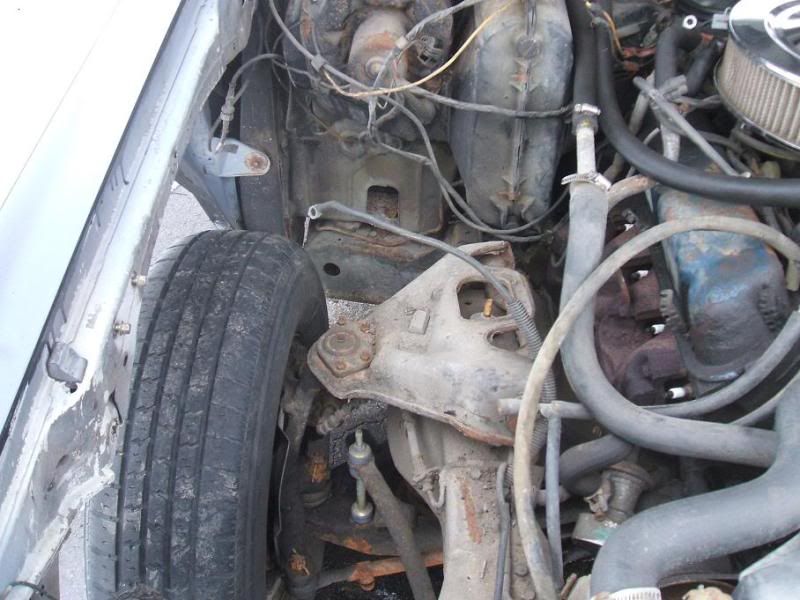

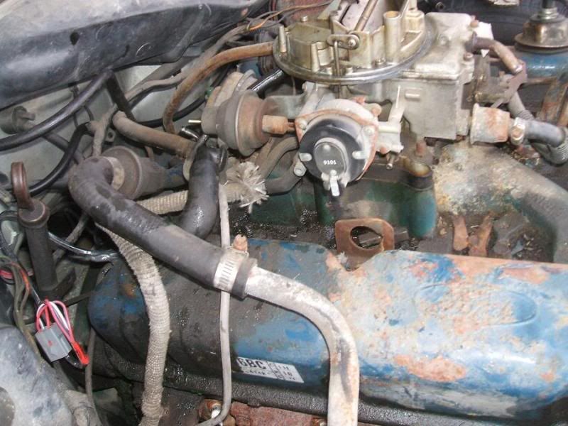

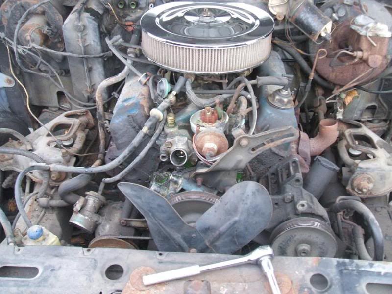

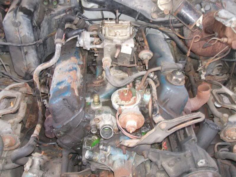

                          Ok here are some more updated pics.
                          So far got the inner fenders out, rad, all hoses, vac lines ect... All un-needed vac lines will be removed. There was a mess of them on this engine.
                          I also have a set of mark 7 headers for it. going to get E7 heads and a decent cam, and a 4 bbl intake

                                #45
                                i see the intake is leaking
                                pull the timing cover while you got it apart too, replace the harmonic balancer, and the timing set........the early 302's have that nylon cam gear that fails
