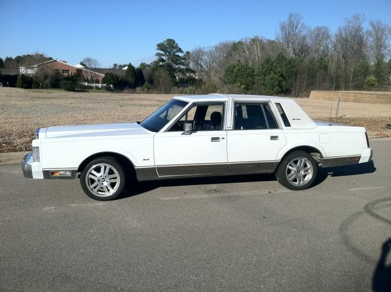

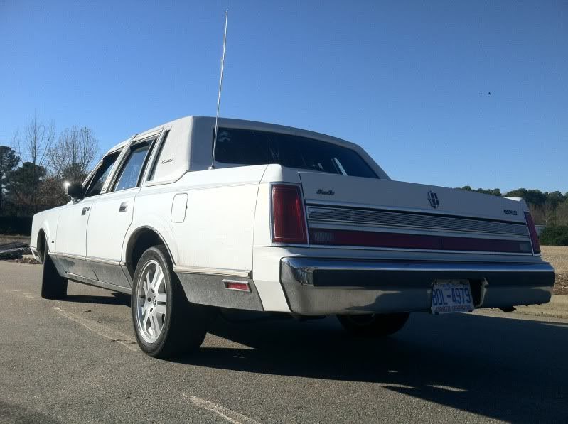

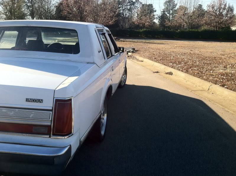

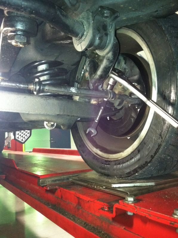

      Just a little update, she is running and driving down the road great! All the gears work well and shift points are correct. The new steering is tight and I just set the alignment today. Have about 0.7* negative camber and about 5.0* caster. Rides great, it's nice to have her back!!
      Brakes are OK, need another bleeding session, I went with a new AC Delco 89' master. I somehow did wind up with 2 Left front calipers so there is probably still an air bubble in one side haha.
      Have some pictures:

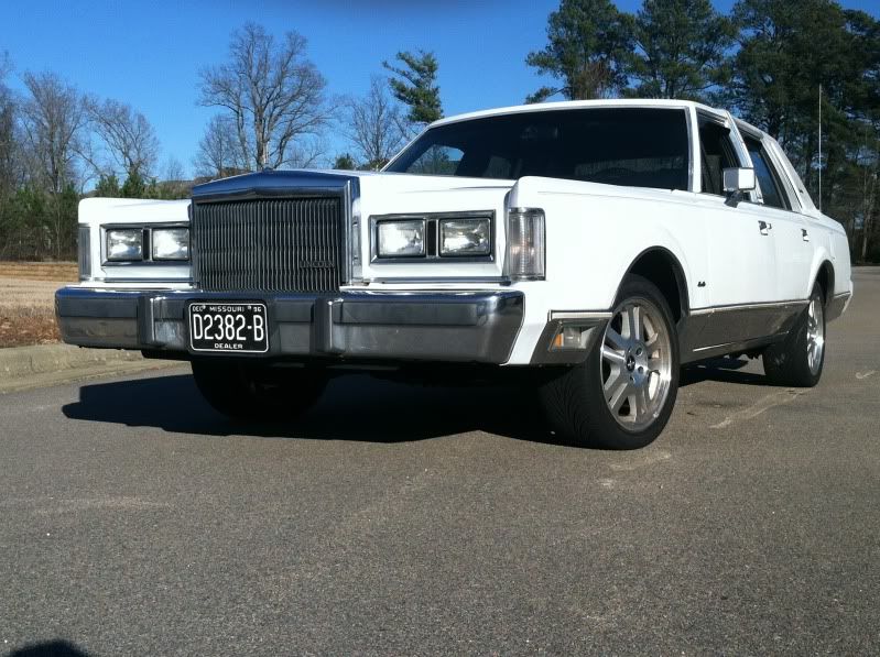

                          An update: Anabelle is running great! Just need to get a new H-Pipe because the stock collector is too small for my FRPP headers and it leaks a little. Also going to put heat and AC back in soon, I have all the parts from a donor Vic from school. Got to totally strip an 88', I'll try and get some pictures of that up ordeal, pulled the entire dash and column out, every vacuum line, every wire, it was intense! Here are some fresh pictures of the old girl after a wax! Original paint and top!

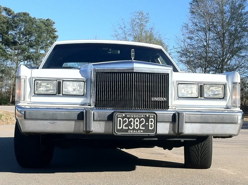

                            Your state doesn't give you crap about having a front plate from a different state than the rear plate?
                              That car is clean as hell, and I like the RD sticker.
                                Not so far no! Since NC only requires the rear tag, I think the front is free game!
