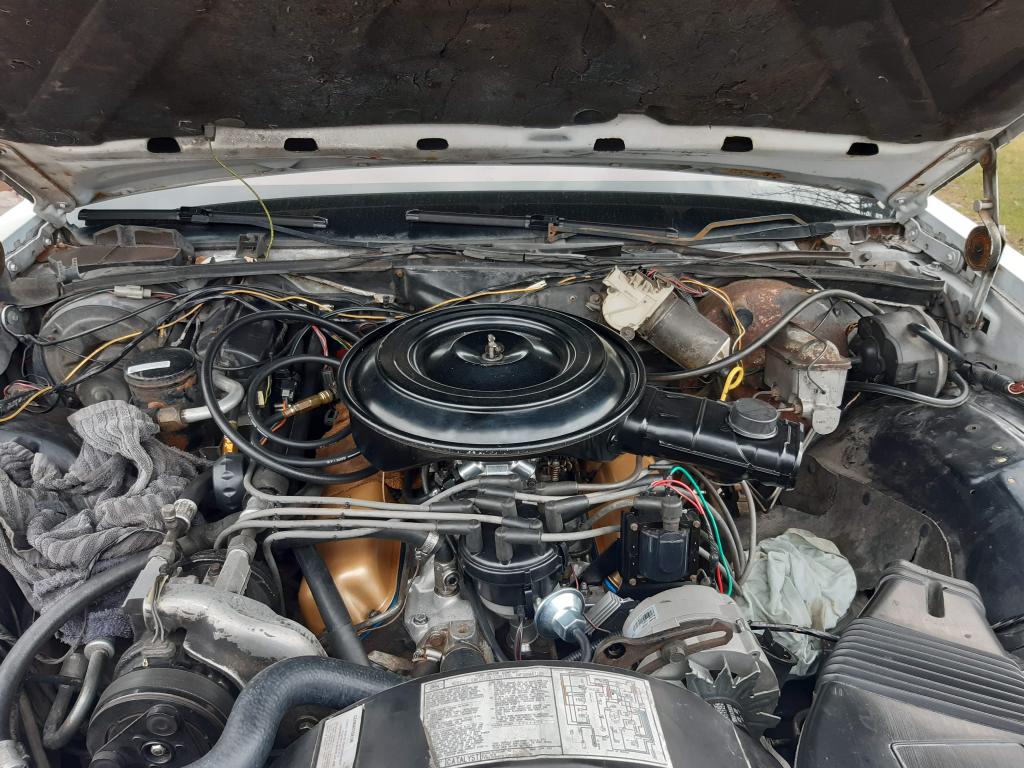

      We have considerable progress today!
      -New upper rad hose, heater hoses and heater valve installed, fancy new stainless clamps mostly.
      -Heater valve vacuum connection is awfully sloppy and loose, ziptied tight for now. Does the heater valve have an independent thermostat or does it use the engine harness' sensor or the temp switch?
      -Finished fuel lines for now (temporary gauge installed)
      -PCV and vacuum advance lines done, used a 90° fitting on the PCV line since the Holley's hose barb points the wrong way.
      -Fuel pump relay relocated to a smarter spot.
      -Adjusted the distributor by eye to be about where the old one was.
      -Reinstalled plug wires, not yet done nicely or anything.
      After I finished up the fuel setup, I pressurized the system and let the fuel pump run for a while. Regardless of the mess of hoses and shitty hose clamps, I only had a minor leak from one of the fuel bowl bolts. Snugged it up and no more leaks, which was somewhat of a surprise. Front bowl float level is pretty spot on, a touch above the middle of the sight glass, rear bowl float level is down a bit, to be adjusted later.
      A bit of an inconvenience being the fact that my gauge doesn't show anything for fuel pressure... Dunno if it's the awkwardly long hose of the gauge that's causing it or what. Obviously the pressure isn't too high since the float bowls didn't flood, but I have no clue how low it is either. The gauge should've atleast moved a bit. A single retailer of the pressure regulators says the factory set pressure is 5 PSI, which would be enough. Factory high pressure pump definitely flows enough either way.
      Fuel in an unknown used carb: check
      Bastard ignition copied from a hand-drawn diagram: check
      Heater and rad hoses in place so what's left of the coolant doesn't spurt out: check
      Plugged vacuum sources: check
      The starter struggled a bit at first since the battery terminal was just slapped on, but HOT DAMN SHE FIRED RIGHT UP! And stayed running!
      The choke was set on a bit aggressive, but I manually clicked it off and kept it running by modulating the throttle. Without throttle it would stall, obviously, so I don't think I have vacuum leaks.
      I have no idea on the idle mixture, timing or anything else really, but she actually idled and responded well to a bit of throttle.
      Didn't run it for too long since there's barely any coolant in it, but enough for it keep idling without choke. Minty!
      Tomorrow I'll get coolant in it, get the base timing set and hopefully start getting the idle tuned. Got my AEM wideband in the mail, which I'll also figure out to install tomorrow.
      I won't be hardwiring / installing the wideband as a permanent fixture, I'll install it for as long as I need for tuning the engine. The factory O2 sensor spot is on the manifold, which goes against AEM's recommendations on sensor placement, as it should be further away from the exhaust ports. It will most likely just affect longevity, so I can just take off the sensor when I'm done and also won't have to have a gaudy gauge in my car.
      Overall, the engine bay isn't too far off from my vision, gold valve covers definitely worked out better than the other option of Ford Blue. Doesn't look too far from what could be imagined as OEM. Still a lot of tidying up to do aswell as actual cleaning. The factory coil & bracket kinda bum me out. Maybe a Pertronix and basic barrel coil at some point?

        It looks good under there. I always liked the look of the CFI cars from underhood, as they've got the old school round air cleaner and what not. The starter hesitating upon initial crank could also be a sign of the timing being too advanced, but you'll work that out.
        I wonder if all those loose/sloppy vacuum connections and the initial loose intake manifold were the reasons why the thing didn't run right with the CFI stuff installed.

          Yeah, the round air cleaner is quite important to me
          The vacuum connection I mentioned in the post above was plugged a long time ago, and I achieved a point where I couldn't any more vacuum leaks. A loose intake manifold could've been a cause for some problems, though I had insanely good manifold vacuum. Either way the CFI is gone now, and I'm actually not that annoyed about not finding an obvious cause for the issues.
