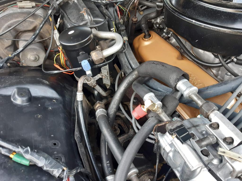

              Got the car back now, about a 700€ ouchie... Oh well, atleast I've got cold AC and damn if it's quiet, the engine and clutch fan drown out pretty much all noise the compressor makes. Great!
              They were kinda intrigued aswell at how incredibly clogged the evaporator got, mechanic said that that most stuff in the evaporator was like a metal paste and would've liked to have seen the old compressor. I showed him some photos, he winced at the carnage, "-no wonder the thing locked up".
              They put in 10oz/3dl of the Pag 46 as requested, also put a dye in aswell.

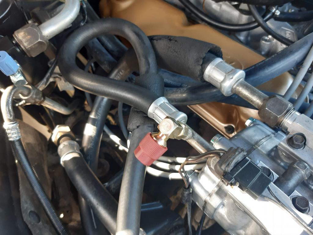

              Even though I put a printed photo of the original line routing, they still managed to get the lines wrong... Doesn't really matter, except the damn high side port is crooked
              The compressor output line isn't routed the same, now it doesn't need the anti-chafe sleeve against the crimps, but it lays on the heater hoses, which are hot of course.
              I'll revisit the clutch connector mounting.
              2005 Volvo V70 Bi-Fuel
                wow... yeah, that's some bad routing of the hoses. Can probably unmount the AC compressor and get that one line off the heater hoses. Considering that's the hot line from the compressor to the condenser, the only real reason I would want to relocate that is to prevent chaffing the heater hoses.
                  That hose is supposed to go over and under the compressor feed hose, now it goes under and under or over and over. If I lift so it goes over the other hose, it sticks up, lays on the other hose and looks dumb as shit.
                  I think I'll make sure it just won't chafe through anywhere.

                    Can you slice some heater hose or another type of hose and make a shield out of it to put over the lines so you don'y have to move stuff? Even if you need to use zip ties to old in place it is easier than moving lines.
                    What I Own: 1993 Mercury Grand Marquis GS
                      Yay for new good working air conditioning. Boo for not listening to all of your instructions and presenting you with that terrible hose routing. To do it right the system would have to be evacuated, disconnect line etc…. Bummer.
                        yah thats annoying but one of those deals you can't really do very much about.
                          It's a bit better now, still an eyesore but less rubbing on other parts.
