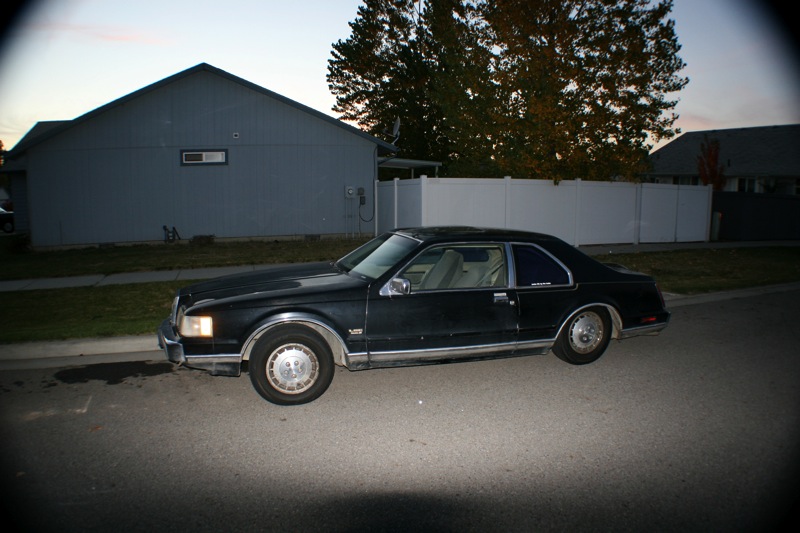

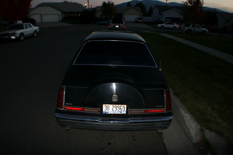

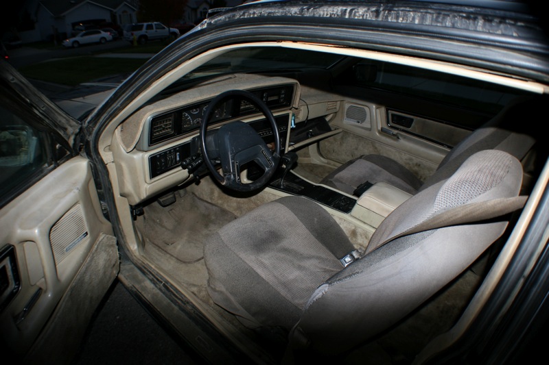

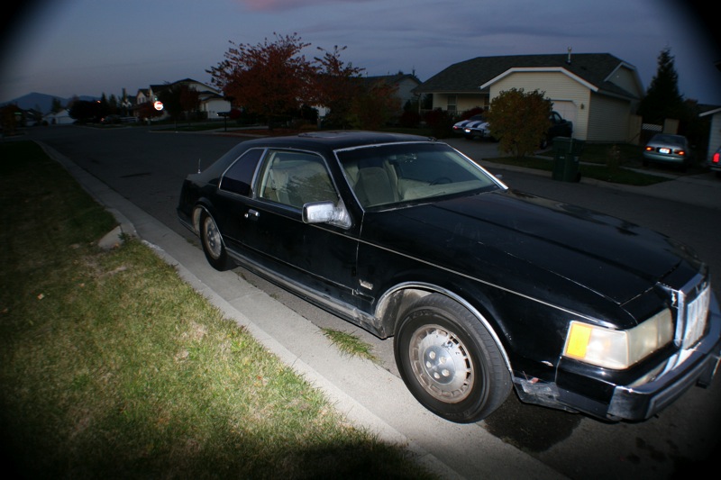

Went and picked up an 86 mark VII today. $400 from a guy who lives on the air force base near here. Problem with the air suspension so it sags ass a lot, sometimes it inflates if you turn the switch off then on again. Has a busted header panel and grille, and a few small things like door locks, etc. Runs real nice though, dual exhaust sounds cool too. A few parts at the junkyard and a good cleaning and it should be well worth the money. I'l use it for my winter car for now so the merc can stay inside. Pics----

nice find, how many miles?
mustang springs do not fit.....the mk7/continental were the best riding fox cars because of the air ride....why rip out a good thing? the air springs are about 90 bucks ea new
hey man I have a pair of sporty red StrutMaster spring replacements for the rear air bags... 40 dolla!!!!Pete ::::>>> resident LED addict and CFI defector LED bulb replacements
nice mang so what's become of the wagon> ps I want your 86 ho plate lol

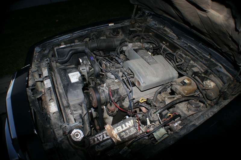

The air springs did look like a pretty simple fix. The other main problem i have right now is the passenger door is stuck half closed. Wont open or close. Hopefully i can get teh door panel off and look in there to find the problem. I was coming home from work this morning and i noticed the car was running like shit; missing and jerking around. Also the MPG display was reading 5 or 6 at 45mph under no throttle. I had the defroster on, flipped it off and both problems went away. Flipped it on again and it did the same thing. So i'm assuming there is a problem with teh charging system. Does that sound like the battery, alt, or voltage regulator, or something else?
Probably alternator taking a dump if I had to guess, though it would probably be a good idea to try cleaning the battery connections, starter relay connections, and ground connections before going to that. A voltage check would also be in order with the defrost on.
I'd actually consider a 3g swap if you're up to it and the alt is toast. the stock 100 amp sort of sucks at low rpms. The 3g also would get rid of the stock voltage regulator so one less thing to fuss about. There's an article in the lincolnsonline.com tech archive for a junkyard 3g swap.86 Lincoln Town Car (Galactica).
