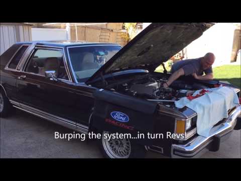

      Oh and a quick vid with some exhaust tones:

                            glad that bolt came out!!!!
                            She sounds so sexy
                              She sounds so sexy
                              Me too. I knew it would though based off of doing the one on the other head last year. Still worries ya.
                              Thanks. Those were all just baby revs to 2k or so. She screams up top. Deafening inside tunnels. Mega smiles from it.
                                You got stick-on insulation on inside of door skins? Makes a huge difference in both ambient noise from the outside and sound system performance inside.
