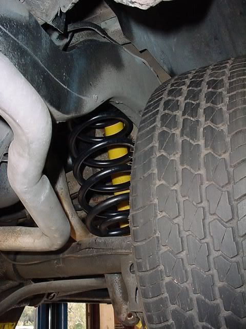

    Got the new springs installed today on the 91... here is pictures... enjoy!

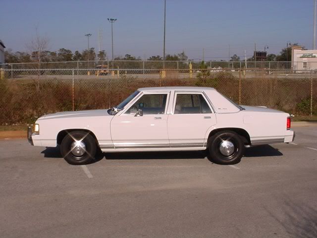

    Before...

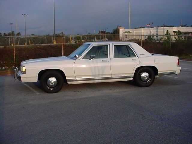

    After...
    During....

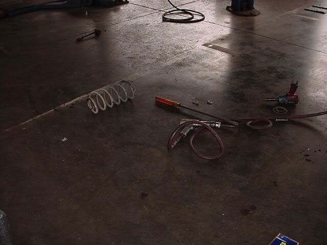

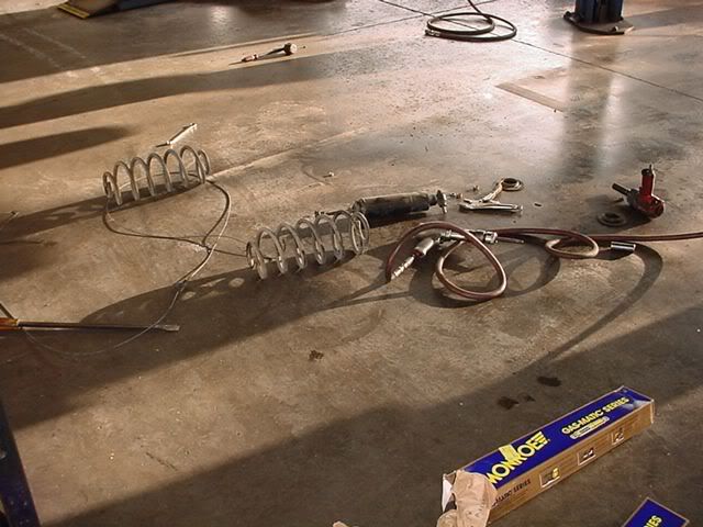

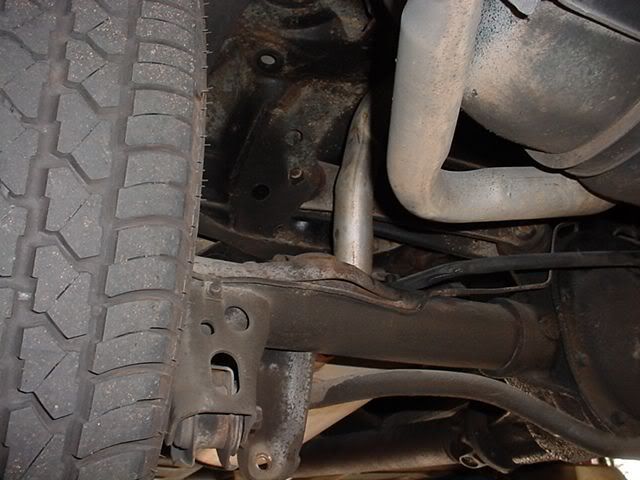

    Old springs / shocks removed...

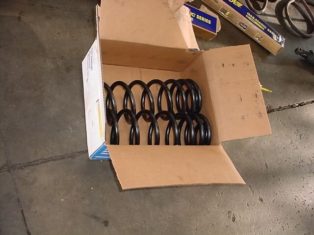

    New springs!

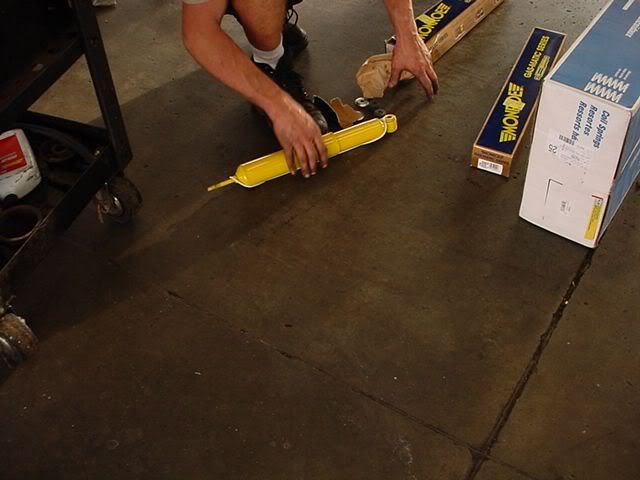

    Prepping the new shocks.. (F-150 shocks) taking the metal bushing out...
    Looks funny with no springs or shocks!!!
    new springs going in!
    An hour and a half later....
    quite a difference...

        wow...gorgeous car ...good job
          Much better now. Your rear looked sad in the before picture.
            Nice mang, what spring did you use?
              Moog CC-819 Monroe gas matic shocks for a 2WD 99 Ford F-150

                    Looks good. I would have thought the rear would have been lifted more with those springs. I had the straight rate wagon coils in mine, and it seemed to be higher (to my dismay). It looks good, just the right amount of lift.
                      Oh, those are wagon springs! Wasn't obvious from the initial posts.

                          Ease of install I could see, but if I remember right, the bags mrltd has were about $75 or $85 for the pair, and aren't springs in the area of $60 each?
                          And yes, I'm thinking of airbags somewhere down the road for both the wagon (to replace or maybe supplement the air shocks) and for my P72.
                            Yeah, he had air shocks at one time. I did the install
                            Lookin' good, mang! The cargo coils will not disappoint!
                              The springs, with my discount at Advance, were 78.00 for BOTH... (Usually about 89.00)
                              They come as a pair.
                              Another 30 some dollars for the shocks.. And I don't have to worry about leaks...
