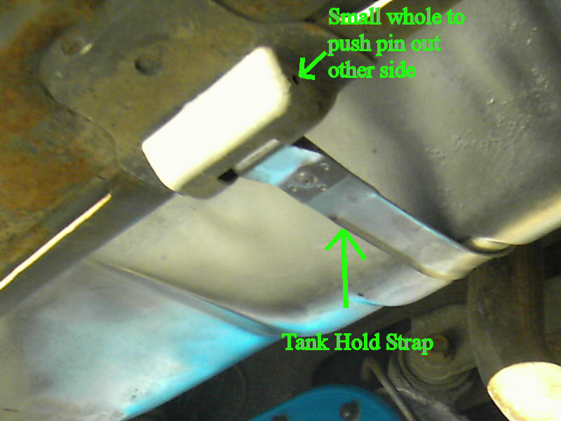

Then remove the two metal strapt that are holding the gas tank up. (Note: Use a jack to hold the tank in place while you do this) There is only one bolt per strap. Located at the top of the tank. The other end is held in by a pin. Once the bolt is reomove the tank will fall some, be carefull that it doesn't fall all the way out. And also be very carefull with these straps, if they get bent at all it makes them ten times more of a bitch to get back in. They are just long enough, and every bend makes them shorter. To remove this pin, simply poke a nail though the small whole and push the pin out the big whole. Straps are now out.
