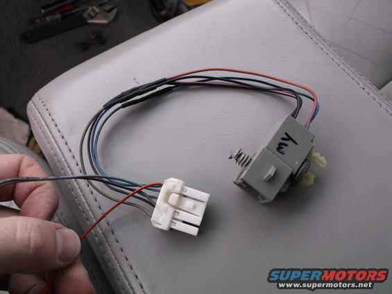

                      Ok so I think I can do what chipdog did and have extra wires left over. The difference between a whale TC/aero is the pinouts. Connector is the same but different locations are used.
                      So if I'm correct in ID'd these from the left it goes: Power, Horn, Speed Control, Key Chime, Signal for Redundant mod & Ground

                        Wired up the Marq clockspring connector to the TC one:
