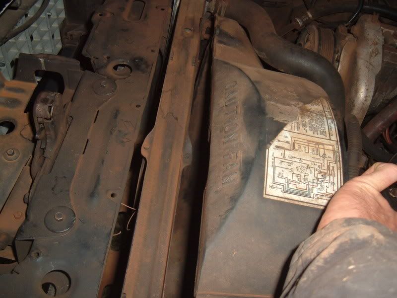

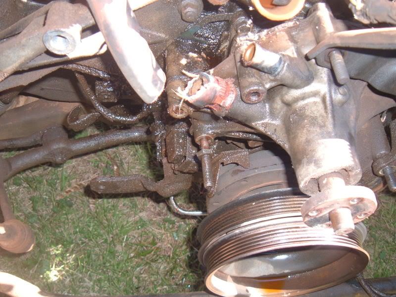

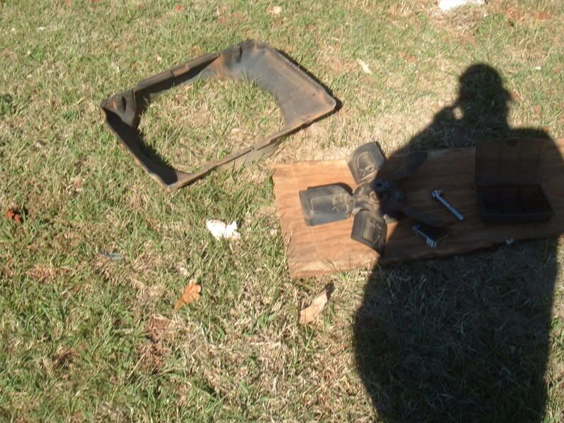

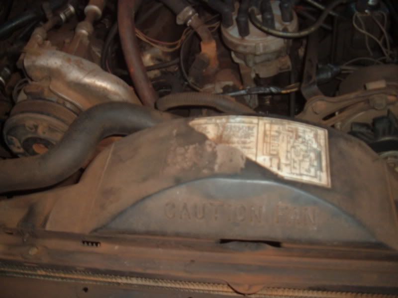

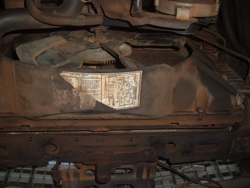

    Update though. I got the fan guard loose and i have the actuale fan loose. I cant see to well atm. so i cant tell how to take the meteal pice behind the fan off... ( Im thinking i shoulda lfet the fan hooked up to that and just taken the whole thing apart.
    Here's pics :P

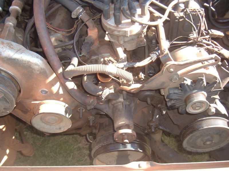

    Heres pics of the metal thing behind the fan..
    Any ideas of how to take this off? Cause I cant find a bolt on it.. ( Although i might just not be able to see it.

        For removing a clutch fan, yeah, it's easier to leave the fan bolted to the clutch and unbolt the clutch from the water pump pulley. Best way to keep the pulley from turning is to leave the alternator belt in place till the fan and clutch assembly is off.

                To do the timing chain, you do not need to remove the radiator. No need to disconnect the cooler lines either. I just did mine about 2 weeks ago, the lines weren't in the way at all. The radiator hoses should come off, and I'd expect to replace them. Half the time you won't be able to get them off the radiator or the water pump, and you end up cutting them. I'd replace the bypass hose and the pump to pipe hoses as well (the two small ones on the water pump). Put a new thermostat in while you have things apart. Its a little bit easier with the timing cover and all that off. You can get in there real easy with a wrench.
                Water pump pulley is held on with the fan bolts. Once you pull the 4 bolts out for the fan, you will be able to tap the pulley off the water pump.

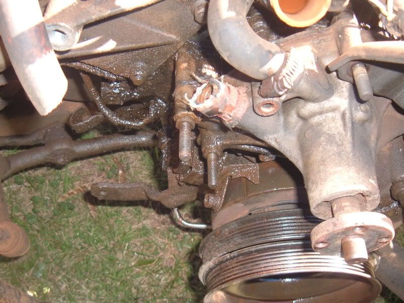

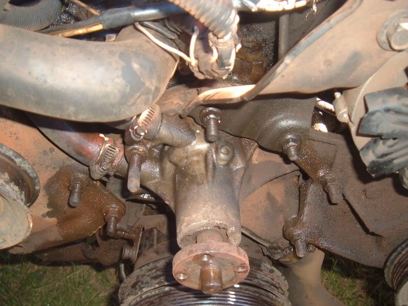

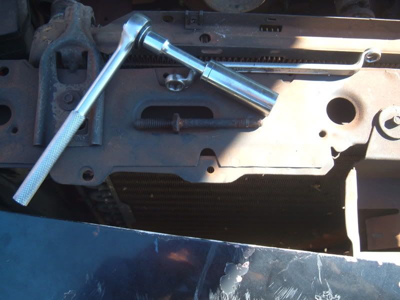

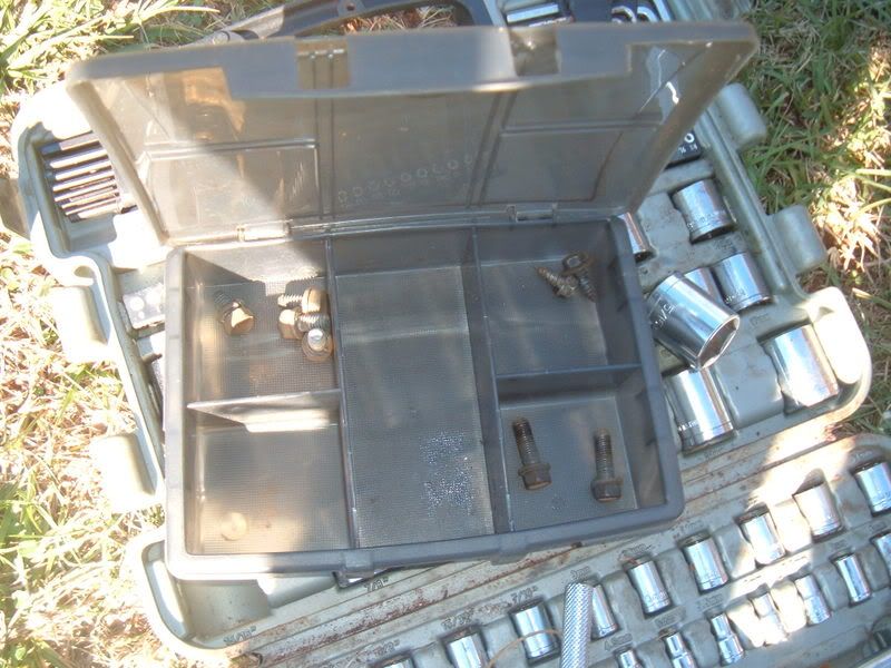

                        Pics
                        This last one, is a bolt and it actualy came out of the water pump. Is this right? it suposed to come out?

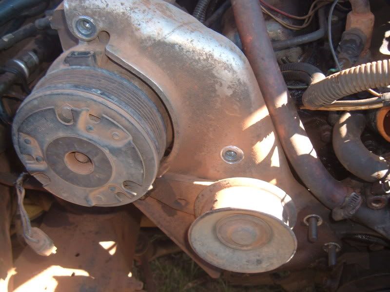

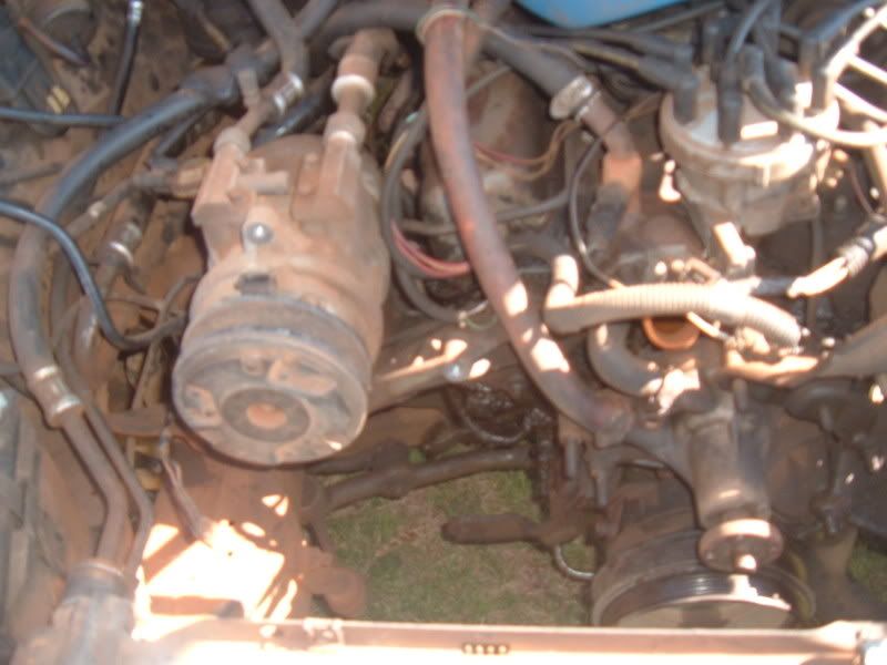

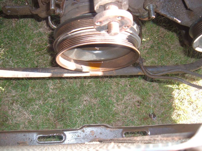

                          Even more
                          Ima take it that that is what the impact wrench is for? I hope mines strong enuff. i cant keep that demn thing from turning
                          Also, I have a bolt not wanting to come out ( WP ) It came almost all the way out, now it just keeps turning. Im actualy think about puting it back in a bit and re trying agine.. you mang's got any sujestions?

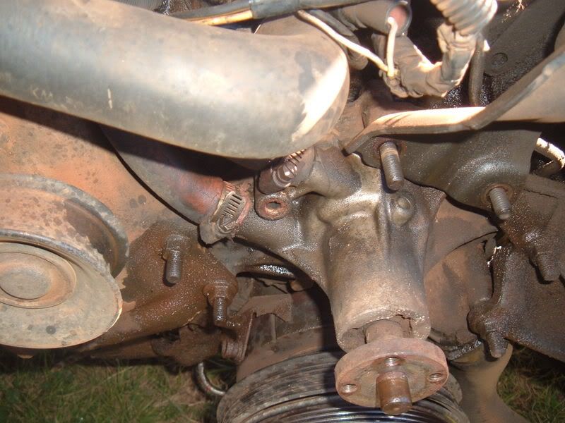

                          O And I take it that the altanator bracket must come off as well, seeing how it's attached the the WP. And maybey ever the Alt....
                          This right?
                          And if that impact wrench wont do it how do i keep them pullys from moving? ???
                              Yep, gotta get 'em all out if you're taking off the front cover. Funny-looking little buggers, aren't they?

                              Balancer bolt takes a 15/16" socket. I have a regular 6-point deepwell I use on it. If your impact won't take it off (like mine usually won't - cheap piece of junk), remove the crank pulley and thread a couple bolts back into the balancer, and use a crowbar to hold it in place while you break loose the balancer bolt by hand.

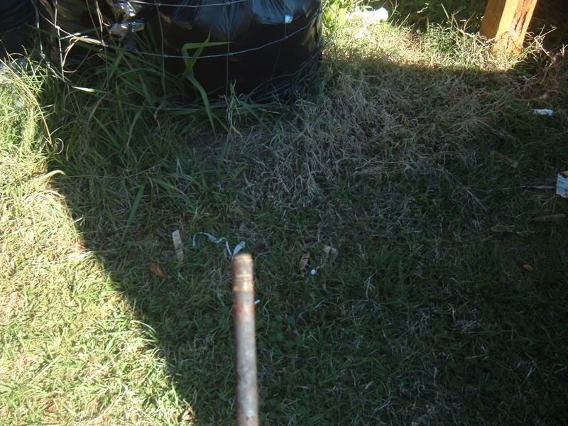

                              Which "one bolt" are you talking about this time? Same one I copied the picture of?

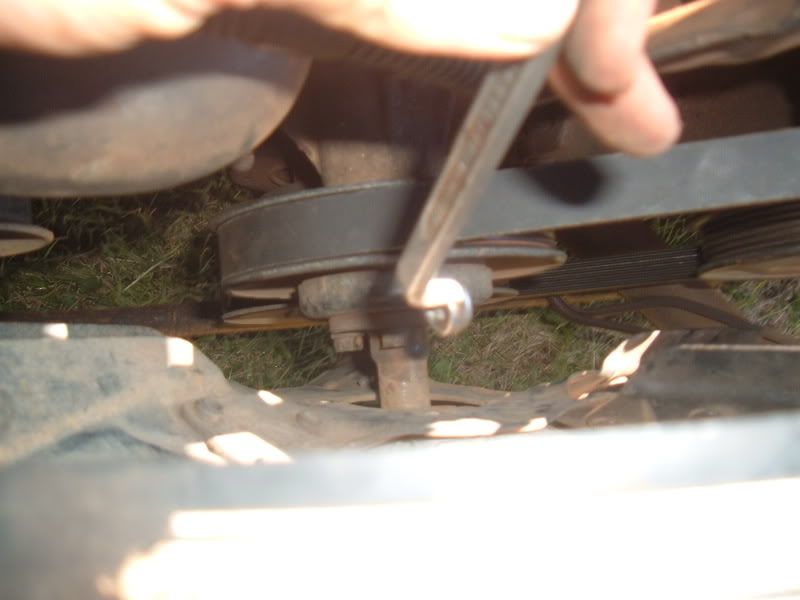

                                Got the pully off L havent tried the balancer yet, still trying to get this one bolt off the wp... And do you half to take that whole hosing off that the altanator is on? thats a biiiig ass pice of meteal
                                Heres a pic of the bolt Is there anyway i can chop that thing down to get my impact wrench on it??
