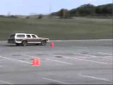

                          I have many witnesses of my bone stock wagon going sideways at ScottFest 1.

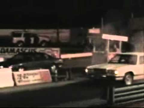

                          I hold the brake and floor it. Not much to it. Heck, my 91 stock except for a flowmaster on the stock SINGLE exhaust ran a 17.35 and I did a HUGE burnout at the track with it. First car in this vid is my HO converted 87.... then my 91... notice the giant cloud of smoke.
                          This is my stock wagon with a PI rear bar and a 3.73 trak-loc rear....And a flowmaster....on the stock exhaust (had a pair from a mustang....the other was on the 91)
                          The 87 vs. the 91 HO converted, lightwieght, gears, etc... vs 2.73's and a flowmaster on stock exhuast....All the screeching is from the 91.
