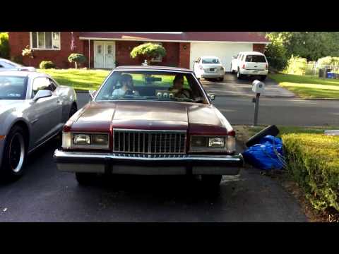

            Video with Proper 7psi, i had the dizzy vacuum disconnected, i want to set the timing properly this time and go over the valves. but as you can hear it sounds much much much better, no more starving for fuel!

                            got it figured out, took it all apart today, the timing was on mechanically, then i started looking elsewhere. low and behold the race balancer i got has 3 sets of timing marks.... hmmmm, dug through the pile of parts and found the factory balancer... i was using timing marks that were completely 1 tooth off from the ones it was supposed to use... sooo i made sure it was at TDC on compression, re-stabbed the dizzy according to the correct timing marks on the balancer and put it all back together, fired right up, timed it to about 20 degrees and......
                                ignore the grind, lol, i'm used to my cruze where reverse is to the left and up..... lol
