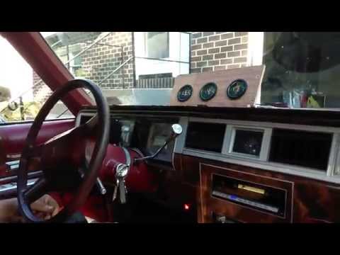

Ok its been quite a while but the 347 - t5 swap is making progress!!!
    The idle sounds a hell of a lot better. Wrong set of timing marks would definitely make sense there.
    I don't believe the T5 has a synchro for reverse anyway. Grind it till you find it
      lol, yea, its definitely better, my brother uploaded an in car view, i still need to tweak it a bit but its definitely a lot better.

            alright guys burnout video's soon! the merc had to be set aside for some house projects but i'm back on track, i fixed the high idle issue, installed a pcv system, and i'm having a driveshaft from an f250 modded to fit the merc, she starts right up and runs fantastic, i can't wait to get vids of it burning rubber! i've been scouting out rear end parts, i'm kicking myself because i missed out on a set of 3.73's for 35.00 on ebay i'm still on the fence if i want to put a spool or just bite the bullet and go with a trac lok, either way i build it both tires will be spinning, lol
            video of the idle and rev's sounds much much better with the engine dialed in! ( that revving in the background about 1/2 way through is a 2015 chevy ss v8 that pulled behind me, lol, i could barely hear it over mine!)
