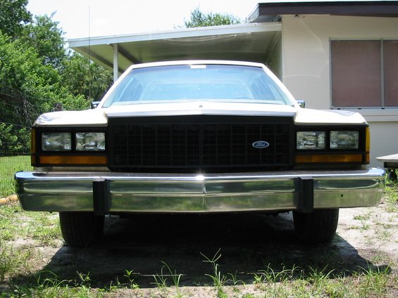

I switched out my chromed steel bumper for a aluminum bumper off a wagon. Unfortunately my old one was a smooth bumper and this one had the rubber strip on it. I left off the two big plastic bumpers, i think it looks a little cleaner without them.
the reason for the swap was weight savings. The original bumper is about 35#s, and its steel support was an additional 35#s, with the aluminum bumper the inner support was aluminum, i cut the support down to a minimum. Total weight of the new bumper and support is about 25#s a total weight savings of about 45#s a huge savings because all that weight came off the very front of the car.

old one
