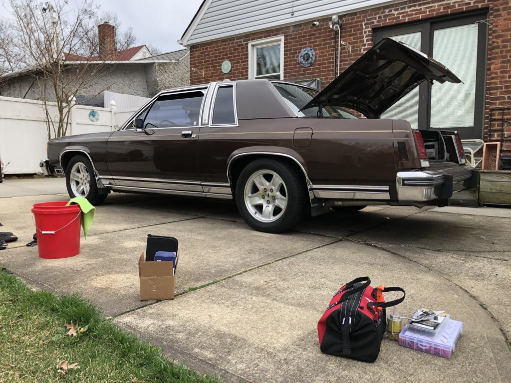

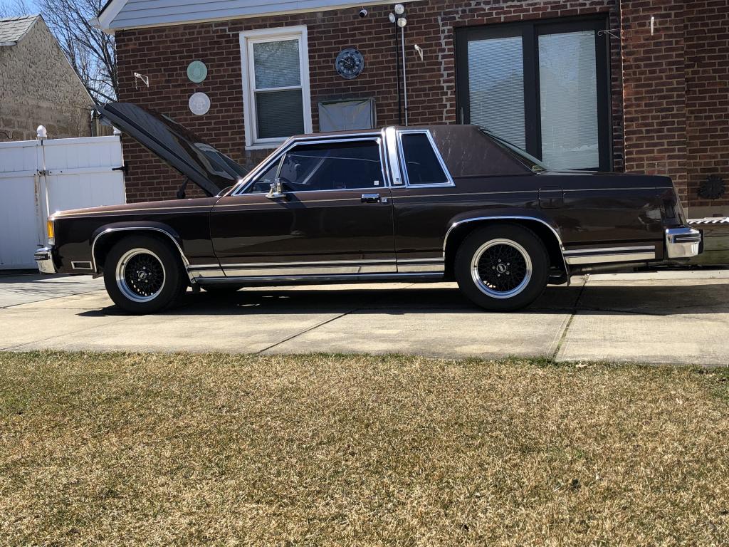

Today I swapped on my favorite wheels in preparation for summer:

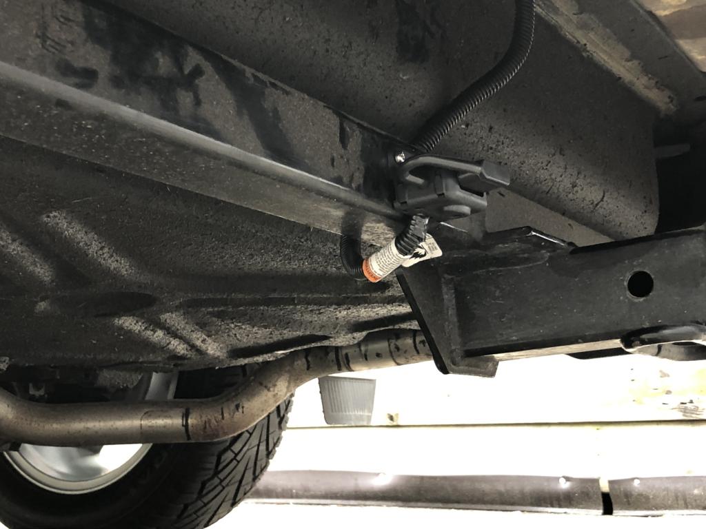

I also installed my trailer harness and 4 flat mounting bracket.

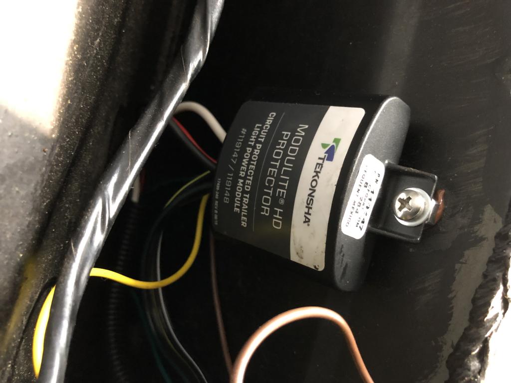

Easy install. Everything I needed (aside from power) was located right behind the drivers side taillight. I then mounted the trailer harness module in the quarter panel well behind the carpets. I used a 10x24 nutsert for that. I used silicone around the nutsert before installing and antiseize on the threads of the bolt.
Power was stolen from my latest under hood fuse box. Fuse three is now for the trailer light module. 15amp fuse. I will only keep it energized when I need to. Otherwise the fuse is riding in the glove box.
I drilled a hole and chopped off the trailer plug and used a grommet to run the trailer harness out to the trailer hitch. I used two 8x32 nutserts with p clamps to secure the harness out of the way. Again I installed with silicone and screws were antiseized.

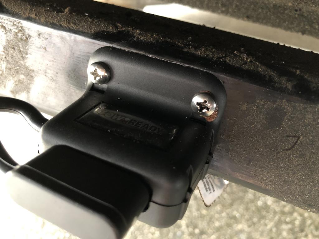

I drilled and tapped two 10x24 holes in the trailer hitch for mounting the 4-flat trailer harness bracket for a nice clean install.
I used a Tekonsha 119147 trailer light power module and a Tow-Ready 118149 4-Flat Universal Mounting Bracket. I have zero complaints.~David~
Do you keep the tires on the wheels or do a re-mount at home?sigpic
