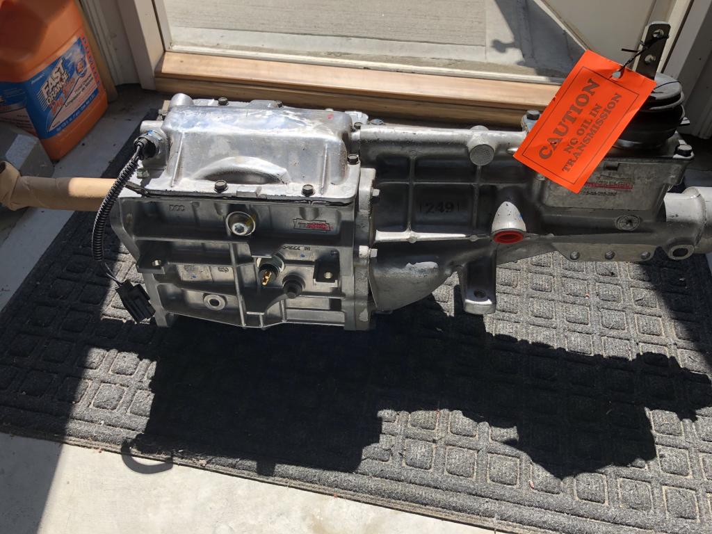

                I got the last thing I needed for the swap....
                Now to let it sit a couple of years (I greased the input shaft where the pilot bearing and throw out bearing sit)....install it...and then break it and put in a better thing.
                  Would be interested in your stock steering column. The whole thing, shift linkage and all, assuming you plan on going with an aftermarket setup after the manual transmission swap. If you’re just keeping the stock steering column I’ll happily buy the complete column shift hardware off you. Not likely that you’ll need the column shift stuff with a floor shifter equipped race car. We’ll be in touch when the time comes, I’m sure!

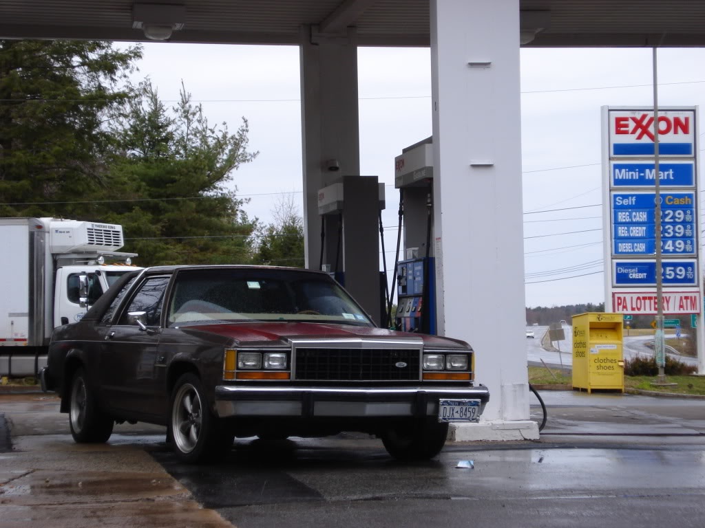

                      Stretched her legs the last two days. Was beautiful out yesterday. Today a bit overcast and windy, but no rain..yet.
                      Two pics from today:
                      And one from 10 years ago just because!
                      Car is running great.

                          Is that pic from SF?
                            Nope. It’s from a trip to Scott when I picked up my new hood. Came from a 1979 ltds. My old hood had some issues on the main ridge line.
