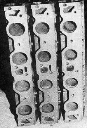

    port sizes stock302 stock429/460 CJ429/460
    Still waiting for my headers to get ceramic coated so thought someone would enjoy this.
    Took some pics of port sizes.
    Up for comparison is: stock302 stock429/460 and CJ429/460
    I don't have anything to show for the CJ intake. Stock429/460 intake is 2.26x1.98 CJ429/460 intke is 2.60x2.24
    Stock429/460 exhaust is 1.69x1.25 (shown by the gasket) CJ429/460 exhaust is 2.08x1.50

        Let me try these pics again...
        I don't have anything to show for the CJ intake port. Stock429/460 intake is 2.26x1.98 CJ429/460 intke is 2.60x2.24

          CJ Intake and exhaust
          CJ/PI/Std
            Those CJ heads look deadly.
              Found the pic I was looking for... I keep finding ones I thought were gone when my computer crashed.
              You can see the revision of the ports by Jon Kaase.

                Holy crap look at those ports!!!
                  If you think those ports are huge you should check out the ports on Kaase's Boss 9 heads!!!!
