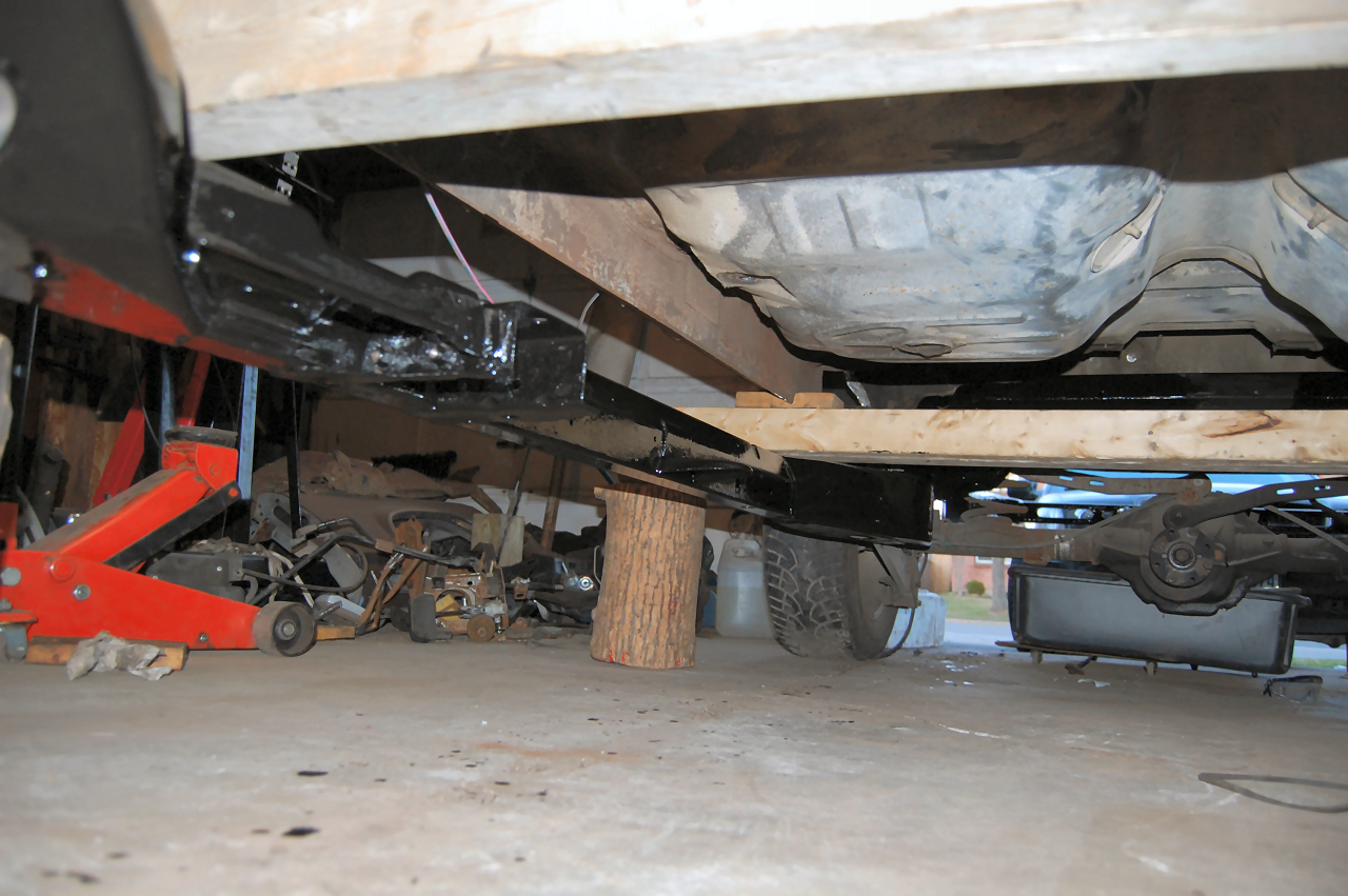

                Not much of an update today but I jacked up the body off the frame and went nuts with a grinder to the rest of the frame. It is now clean up to the rear axle. I am not sure how I will do the rear section. I think best bet is to pull the rear end so I can get into all the crevices.
                  I'd say that is a good idea. Pull the arms and you have all the room in the world then to work with.
                    Finished grinding the frame today and put 2 coats of Miracle Paint. Decided not to do the area around the axle for now. When I swap the gears I will pull the axle and paint that area at the same time. Gonna let it dry for 24 hours then apply a top coat of regular semi gloss black enamel.
