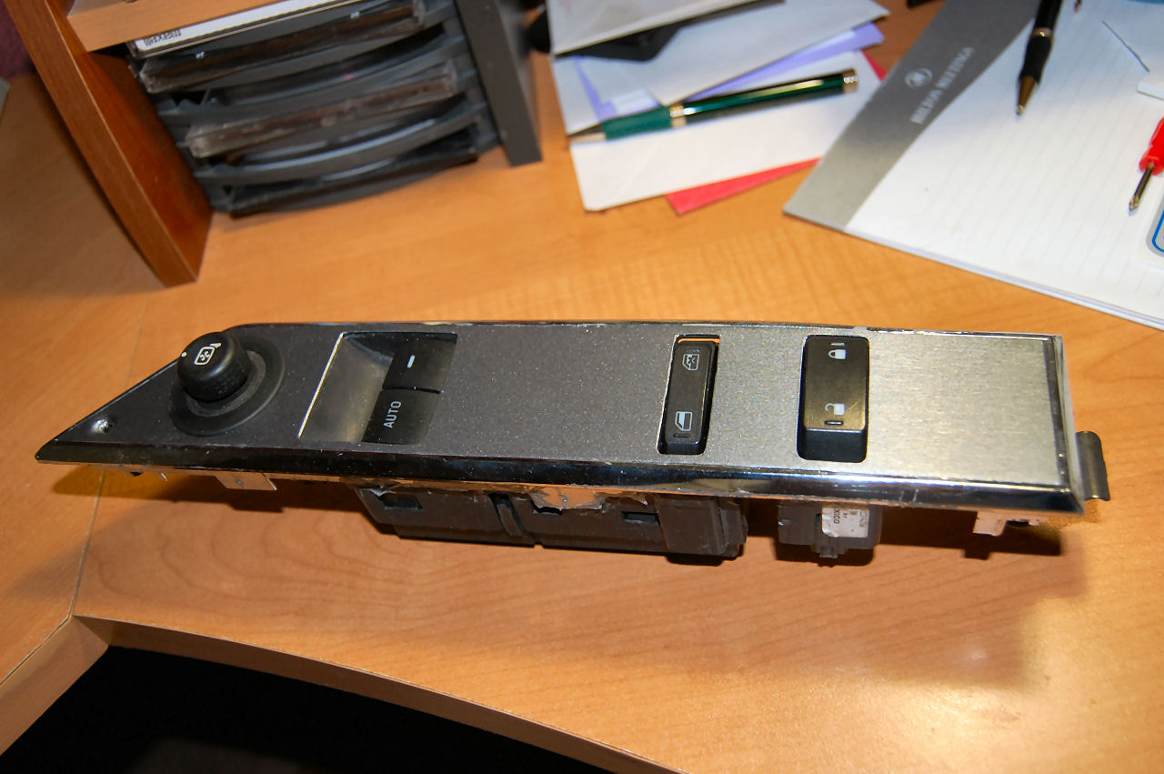

    The switches look fantastic. What did you use to cover up the existing holes? (I'm assuming you pulled away the thin metal covering over the plastic and replaced it with your own?)
      Yea, that's basically it. Peel the old covers off, glue the new switches into place. Clean up the area so it's somewhat smooth. Then I used some construction aluminum to cut out new covers. I covered them with brushed stainless steel vinyl to match the rest of the trim. Hardest part was cutting out holes for the buttons and filing them smooth.

            I've been putting off the switches because they are tedious but they are finally complete. Driver side didn't come out as nice because I chipped chrome surround in a couple of places. I will see if I can touch it up with something.

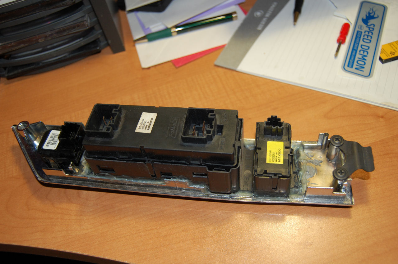

            If anyone is curious what they look like underneath, this is it. If the switches ever fail I can simply grab another set from a 2011 and swap them in.
