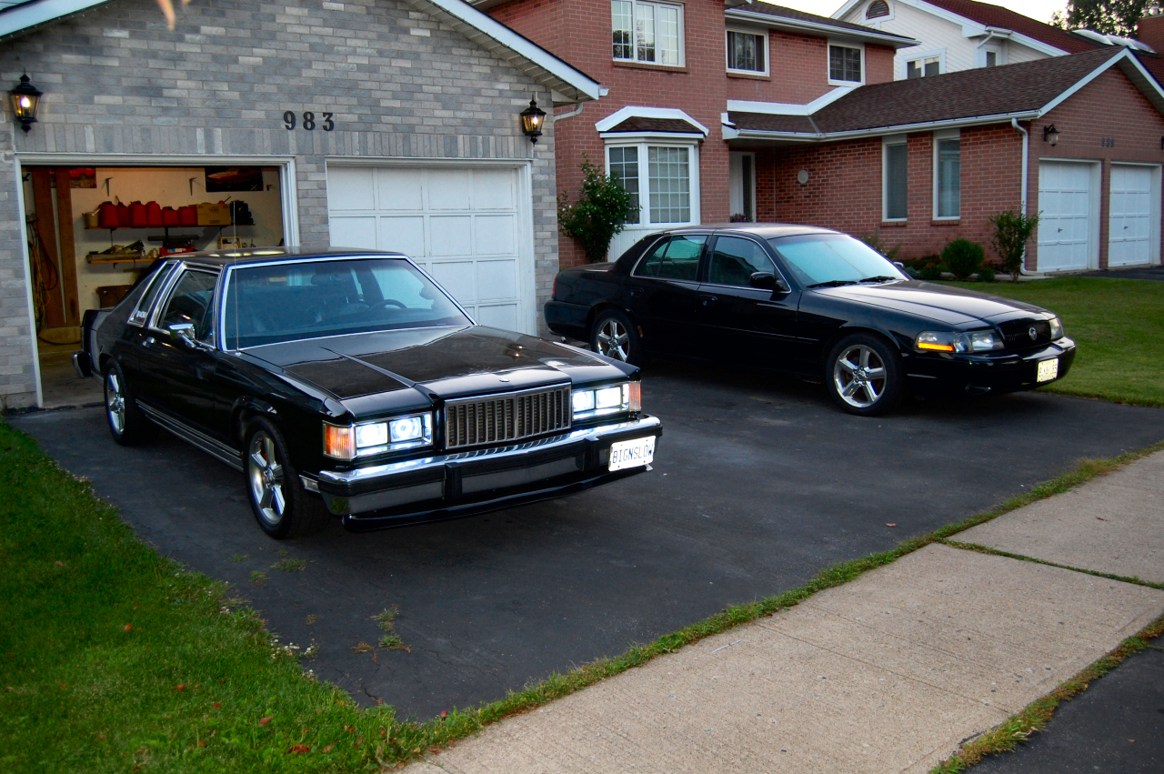

                    Was shuffling cars around the driveway, snapped this pic. Modern vs classic.
                      So nice.
                        Should throw some marauder badges on it, I'd say it's worthy.
                        Originally posted by SVT98t
                        Up and down.
                          I still say you should 4v swap it, and throw that old 2v in the rauder.
                            Keep it as they are, only Procharge the Marauder, and TKO, for both when the slushboxes go.
