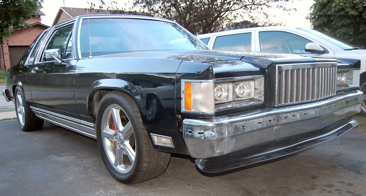

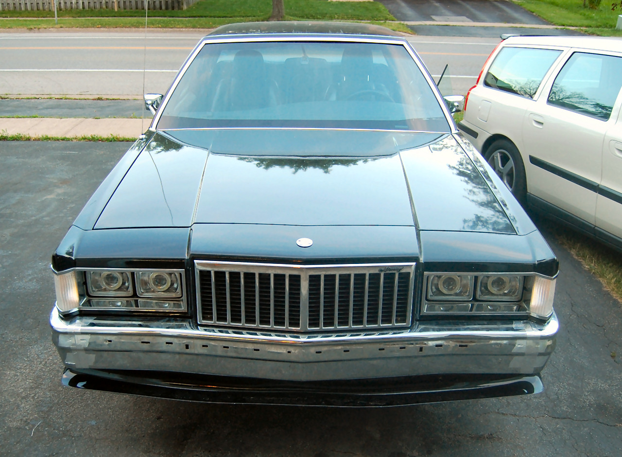

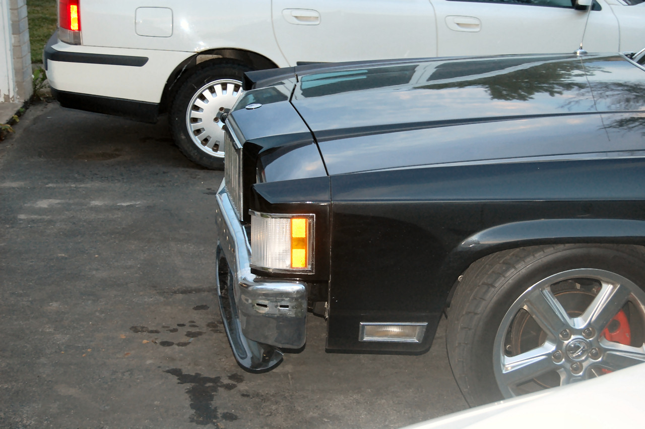

    Love it or hate it this is happening. Removed 3.5 cm section on each side of the bumper. This is just a mock up as I still need to weld it all up. I plan on welding up all the molding holes as well. As far as depth goes, I might bring it out some, will figure it out later on.
      Finally, one of these that the bumper fits correctly on. I really do not care for the stock calf-catcher design. It always looked like someone fucked up reading the prints when they made the metal stamp, and by the time someone realized it was too late to fix so it rode for 8 years. Lincoln only ignored it for 5 at least. Its probably the single biggest reason I prefer the 88+ models.
      Now it just needs something to fill the gap between the bumper and fender.
        Stock filler pieces still fit, just need a little trimming. I didn't put them on for the mock up pics.
          +1 fits!

            Honestly on the fence here. Always kinda liked the boxy boxes because they look a bit wrong, although I must admit I'm not a huge fan of the tudors so way off here. I think the finished result with everything cleaned up in place will look good, but appreciate how beefy the early boxes look with bigass silly bumpers. It'd be a nightmare for me parallel parking every day though. I'd probably rip off a bunch of dumbass camry bumper covers and shit.
            Beautiful job on the door panels Bean, i'm jealous in just about every possible way. I not only have no time and little skill for such things, but also a severe lack of patience. You must be a saint. Probably don't even yell at your kids.
              Man I love the custom door panels! Looks great!
                Shrunken down! Does not look bad.
                  Bumper looks good in mockup form. The bumper "peak" seems to line up well with the corner light "peak". Let that be your final guide.
